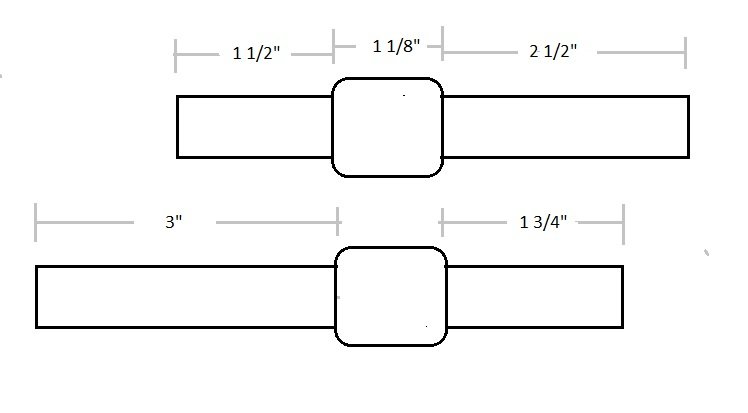

Here's a diagram of the two water pump bearings and how I would orient them. The original is on top, the new on the bottom. There will be plenty of room for a coupler on the right side of the shaft, the original was longer than needed. I have to check but I think the right side of the shaft on the bandsaws I have are of different lengths. They may have used bearings with different length shafts over time. Measurements are only accurate to about 1/8".

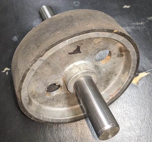

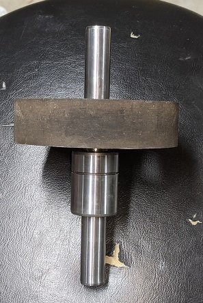

Called Shopsmith this morning and they said they had 1 wheel and bearing assembly in stock. The very nice service person wasn't all that convinced the part was actually on the shelf but I wanted to strike while the iron was hot, or soon to be in this case, the aluminum was hot. If I in the end I had to wait for a replacement I figured I could live with it.
Turned out not to be a concern. I heated up the wheel and knocked the old bearing right out of it. I was going to try to work out some kind of puller or just get one but I just hammered it out with a big pin punch. I was worried about the tire. I wrapped wet paper towel around it initially, but couldn't find my big rubber bands so tied it down with some string. Very soon that was slipping off so I grabbed a small paint brush and painted the tire with water as I heated it. The water was steaming off the tire but it wasn't melting. When I could see the shaft separating from the hub of the wheel I knocked it out.
Once it was out I could see that the hole had been machined for about 1/4" in to a slightly wider diameter. That probably helped them get the bearing shaft aligned and pressed in, and it would help me too. So I put the new bearing in the freezer for a while, then began to heat the wheel, painting the tire with water as I went. And then found that the tire was hot and expanding and could now slip off the wheel. if I was smart enough to figure that out I could have started out doing that and instead of a heat gun I could just put the wheel in the oven. Since I was already mid-heat I just continued with the heat gun. When it looked plenty hot I took the new bearing and banged it into place. It went pretty easily. I had already worked the spacing between the wheel hub and the bearing side of the bearing itself and had a piece of steel of just the right thickness to use for gapping. I needed to hit it a little harder than was needed to remove the old one, but not so hard I worried about damaging anything. I slipped the tire back on while it was still pliant. It seems to be on tight enough.
As soon as it cooled I fit it in place in the sander casing. It has a tiny amount of play in the casting hole, I'll try a little aluminum foil shim to get it tight. The bearing shaft sticks out at least an inch on the right side, and on the left it will stick out from the door only about 1/2 inch, so the hole will have to be big enough for the end of the coupler to be partially inside the sander, and it will need a little extra notch for the door to swing free.
I still have to grind flats into both ends of the shaft and then re-assemble the whole sander and try it out.
Here's a couple of pictures of the new bearing and shaft installed in the wheel. The bearing is on the right side and fits in the casing, the longer shaft will stick through a hole in the door of the sander on the left.
