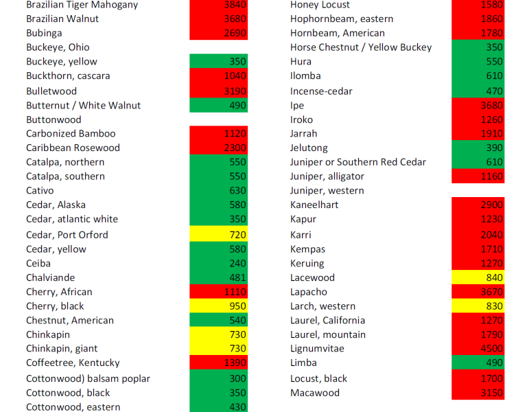

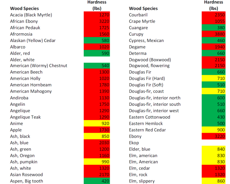

As I understand it you are asking for feedback on your chart and its usability.
With that as my goal...
I love the idea and it is obvious a lot of thought and effort went into the chart. There is a HUGE amount of great data here but...
My old eyes cant read it. It would be a much better effort for me (I know you made it for you not me:D) if it were in a larger font even if it ended up spread over a couple of pages. Or the front and back of one page that could then be laminated and hung on the wall above or even attached to the tool where I expected to make the most use of it.
Just my thoughts, you did ask:o

Print it out greater than 100% size.mikelst wrote:As I understand it you are asking for feedback on your chart and its usability.
Thanks for the input - here's the second part
Still a work in progress so I will take your ideas and continue. It's now cleaned up and just a tad larger.
The second half is specifically for the ProPlanner upgrade is a speed/feed chart.
You can find the pdf here => http://beasleymhb.home.comcast.net/~beasleymhb/wood hardness and speed_feed.pdf
PS - Understand this is meant to be a quick reference only. Also I removed th s off of http so you shouldn't see the security certificate error.
After bypassing my security (computer claimed the site had a certificate error) I was able to view the site.
Lot of work here and that is to be admired!:) It is a large compilation and gives a good general idea of hardness of many species.
However, given the numbers, I was unable to tell if hardness is expressed in pounds/sq inch or other. Also, I would want to know if the chart addresses wood of what moisture content, is it speaking of compression hardness, shearing hardness, and is this table a combination of the above.
Does the table address hardness perpendicular to grain or other. Most tools cut into wood at a shearing angle. It's pretty hard to cut perpendicular to the grain. I believe most woodworkers don't really care about how many pounds of pressure or strike will crush wood. I think they just care about is one species generally harder than another.
If all one wants a table of how easily a ball pien hammer will leave a dent in a dried wood board, then we don't need a table with pounds - all we need is the colors.
If we desire more precise information, then Chapter 5 (Mechanical Properties of Wood) in the "Wood Handbook" will give those precise numbers. http://www.fpl.fs.fed.us/documnts/fplgtr/fplgtr190/chapter_05.pdf

Then id does not fit on a 'page' or single sheet of paper so formatting is lost.JPG40504 wrote:Print it out greater than 100% size.
If it were available as a spread sheet self formatting and alignment would be possible.

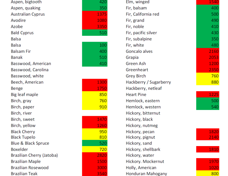

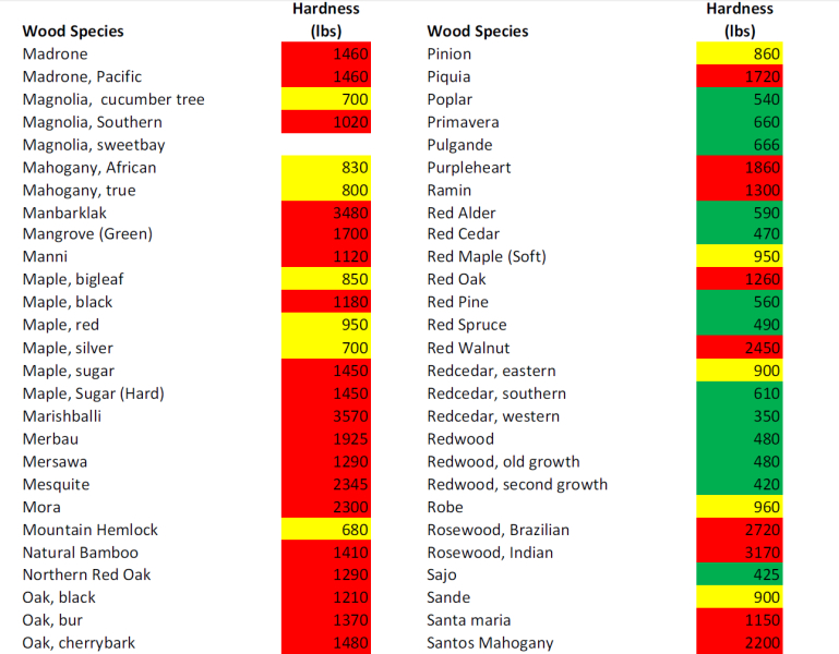

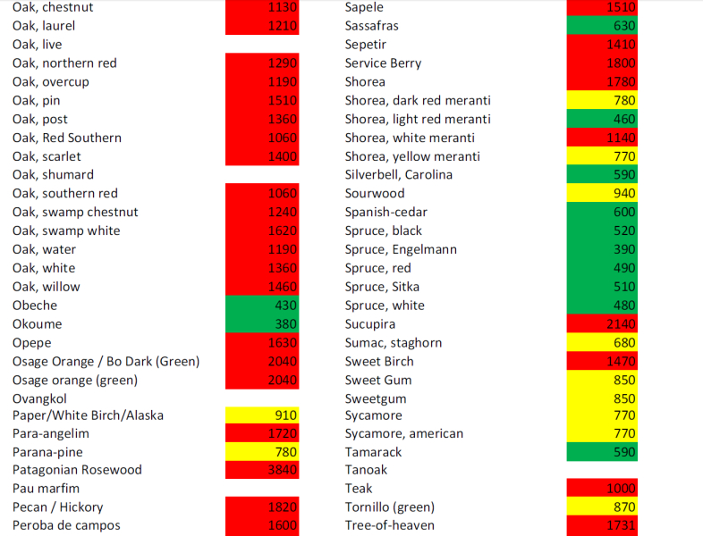

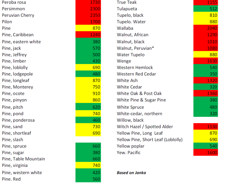

Try these!
[ATTACH]14510[/ATTACH] Speed chart added after initial post!
[ATTACH]14504[/ATTACH]
[ATTACH]14505[/ATTACH]
[ATTACH]14506[/ATTACH]
- wood hardness chart scn ul.jpg (329.88 KiB) Viewed 2524 times
- wood hardness chart scn cl.jpg (318.58 KiB) Viewed 2527 times
- wood hardness speed chart scn ll.jpg (326.96 KiB) Viewed 2527 times
JPG40504 wrote:Try these!
And these:
[ATTACH]14507[/ATTACH]
[ATTACH]14508[/ATTACH]
[ATTACH]14509[/ATTACH]
Each section is a jpg file. Right click and copy!
- wood hardness chart scn ur.jpg (316.9 KiB) Viewed 2514 times
- wood hardness chart scn cr.jpg (334.97 KiB) Viewed 2513 times
- wood hardness chart scn lr.jpg (309.37 KiB) Viewed 2510 times
