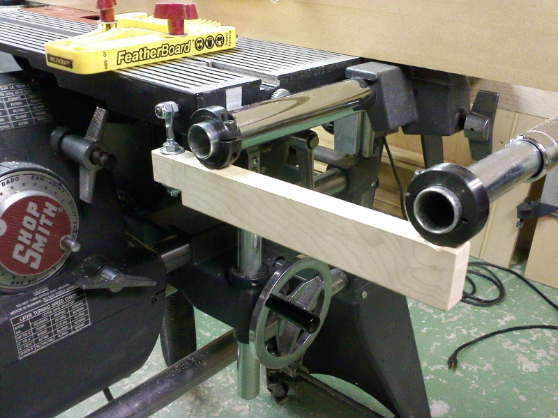

Here is a photo of the longer bracket, on the in-feed side. It is longer to allow room for the standard rip fence handles, etc.

Yes, I could section 510 rails and get something that would fit over the tubes but I would not have a way to secure the rail to the tube. This "clamps" would do that.
Yes, I also could drill and tap holes for set screws and that would work too.
There is another little detail, that I just noticed, that could become an issue for some.
The 510 main tables are not all the same. Onetracks' table is one of the older models and it has holes predrilled in the tables sides. I am told that those holes are there because they were used for "registration points" when the tables were manufactured.
Those holes do not exist on the newer tables. Holes could be drilled but the locations would have to be different. Not a show stopper just a design change.
Ed in Tampa
Posts: 5834
Post by Ed in Tampa »
dusty wrote:Yes, I could section 510 rails and get something that would fit over the tubes but I would not have a way to secure the rail to the tube. This "clamps" would do that.
Why do we have to secure the rail to the tube? I didn't think about it when i made my suggestion. And now that you mentioned it I can't think of a reason it would be needed.
I guess if you didn't use the eye bolt and table pin you would need to clamp to the rails but with the bolt and pin I don't see the supports moving. Am I missing something??????
Ed in Tampa
Stay out of trouble!
Ed in Tampa wrote:Dusty
No, you are not. I missed the fact that the bolts secure the rails in their intended position.
However, those bolts may not be part of an installation on a Mark V with a later version Main Table which has no holes for those bolts unless the user creates them.
Furthermore, I had tunnel vision while thinking about the clamps.
Clamping the adapter rings to the tubes prevents sideways movement(assuming the tubes are 'secure').
IMHO clamping will result in a much more solid support.:)
