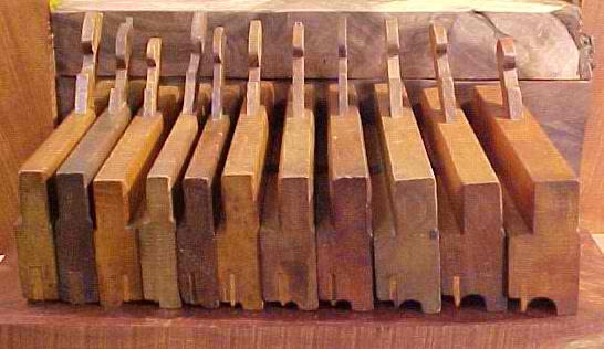

How many RPM's do these run?
[ATTACH]14752[/ATTACH]
- BeadingPlanes.jpg (31.84 KiB) Viewed 1376 times
