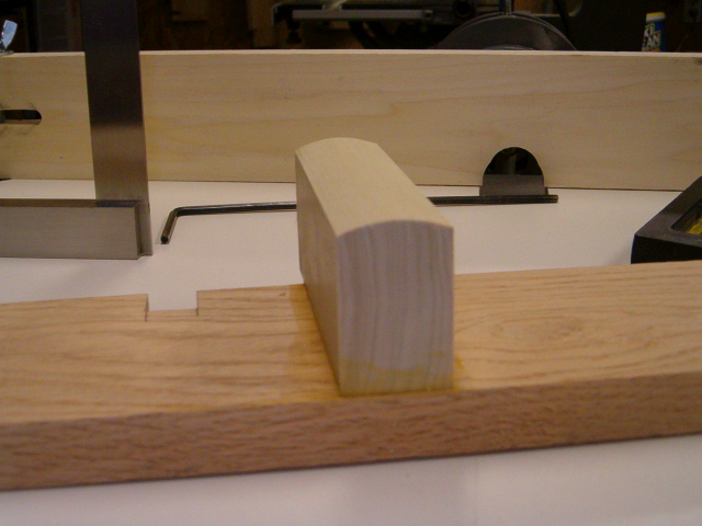

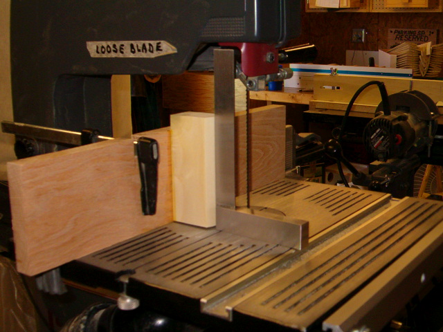

reible wrote:I guess I never give drift much of a thought. I don't have a fence or either my "other" bandsaw or for my Shopsmith. Some where on the forum I posted a picture of the resawing jig I use, it is just a rounded end with provisions for clamping, the idea is that the pivot point sets the thickness and a line on top of the work piece is where the cut should be. Feed and pivot as needed.
Here's mine (for the 4th or 5th posting, I think:o ) If I ever make a new one it will be more pointed. In my reading - many professionals use a single point fence for re-sawing. This one works for me - I'm no Pro!
