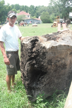

It was cool to find some of my wood on a forum. As I read the remarks I had to make some corrections.
All of our wood is river and lake recovered from South Carolina. We recover our logs from 1700 - 1800's mill-sites. Some of our logs were recovered from depths of 50 feet or more. These logs were growing when Christopher Columbus got here. Yes, you buy modern cypress for a cheap price about anywhere in the southeast. Modern cypress lumber comes from trees less than 50 years old with little to no heart. The growth ring count of modern cypress is less than 10 rings per inch and, at most, only 4-6 ring per inch.
Our logs are all virgin old-growth and ax-cut. The growth ring count in our cypress is a minimum of 20-40 rings per inch. Our logs are 95-100% heart wood. The river normally removes the little sapwood there is. The log in the picture above was only 32" on the small end. We have logs that are up to 60". The 60" log we have has over 800 growth rings not counting the sapwood which is missing.
Pecky in cypress is not caused by bugs or worms. It is caused by a fungus (Stereum taxoii), which works its way into the heart of the tree from the top and works its way down to the roots. This entire process takes decades. Once the tree was cut down and put in the river, the water killed the fungus leaving a Swiss cheese look.

Most cypress were already water logged when they were cut down. It didn't take much time before becoming completely saturated.
wood 012.JPG (107.72 KiB) Viewed 2155 times
