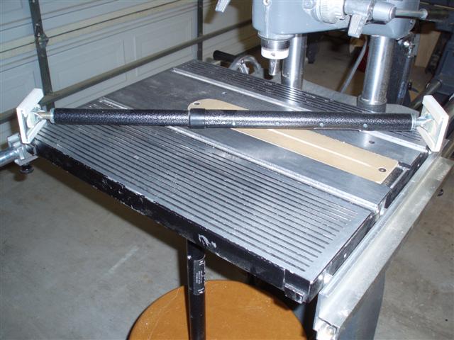

Table Stabilizer, Drill Press Mode
I have repurposed a couple screw jacks that were in my travel trailer. They now have a purpose in the shop - to stabilize the main table during drilling and to stabilize the outboard end of my router table.
[ATTACH]15077[/ATTACH]
