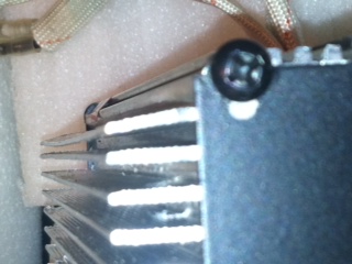

Here are my observations after finishing the PowerPro upgrade process on my 520 machine. When I unpacked the box I discovered the power supply part had one of the fins bent towards the others (see attached picture). There was only 1/16” space between the fins at the top. I called ShopSmith and Dave told me not to worry about the bent fin. I agree leaving it alone was better than trying to straighten it out and risk breaking it off. I just wanted confirmation before I installed the power supply. If there is an overheating problem later I’m sure ShopSmith will make it right. I just used scraps I had on hand as the “stage” and for the board the table legs push against to raise the way tubes to remove the headstock and install the motor. Being somewhat cheap I didn’t want to waste any materials making something for a single use.
