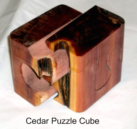

Got one (1/8") on mine right now. Works pretty good for the price.
[ATTACH]15319[/ATTACH]
Three inch cube of aromatic red cedar.

Thanks--And cool puzzle!
