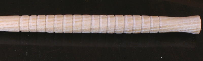

I've made a few handles out of Black Locust and I'm very pleased with the results. My trusty 40 year old hatchet suffered a broken handle a while back and I couldn't find a suitable replacement so I whittled out one of my own.JPG40504 wrote: I'd like to see a pix of that black locust handle.

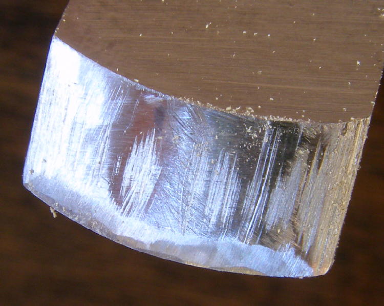

I guess I've been carving wood with a chain saw for too long. When you buy a new chunk of Oregon saw chain it's as sharp as it needs to be right out of the box. If you are good you can make a slight improvement but it is not necessary.beeg wrote:So your chisels are KNOT sharp huh. The FIRST thing ya have to do when ya buy a new chisel is sharpen it and maybe change the bevel angle.
Now that I pay attention I see that the factory edges on my new chisels were atrocious. I did not have much success using a free hand approach and the sanding disc w/ 600 grit. I can see that a guide is necessary to get an accurate face. I used an oil stone - just free hand with no guide and was able to get about 1000% improvement over the factory edge. If I hone this another 50 times or so the divots from original grind might be gone. I had so much fun touching up these edges and benefiting from the results that I'm inspired to strive for perfection. After taking a closeup pic I can see that I still have a long ways to go. I'll probably have to get that SS sharpening guide just to get my chisels to where they should've been new out of the box. After that, hand honing with my Grandfather's Arkansas stone will do nicely.
[ATTACH]15219[/ATTACH]
After working on my edges I was amazed at how effortless it is to move the edge through the wood, and just how much detail can be achieved with some practice.

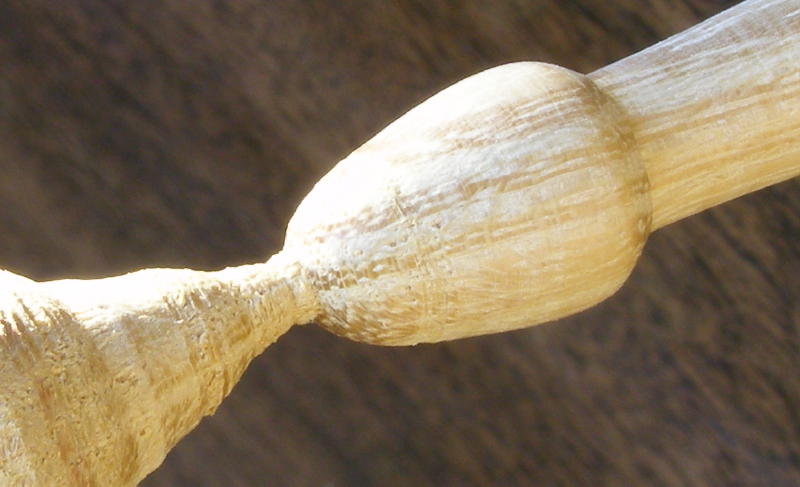

[ATTACH]15220[/ATTACH]
[ATTACH]15221[/ATTACH]
I have to say though that the angle grinder with a fresh 36 grit disc is the best way to rough out these sticks. I takes me only 2 minutes to go from square stock to a nearly shaped drum stick. Of that, 30 seconds or so is with no rotation, then with speed control on FAST, another 90 seconds and the tail, grip and shaft are ready to sand. After making a few dozen of these I can turn the diameters to within .032" by eyeball. It takes a bit longer to make the tip to my satisfaction though.

deec wrote:I've made a few handles out of Black Locust and I'm very pleased with the results. My trusty 40 year old hatchet suffered a broken handle a while back and I couldn't find a suitable replacement so I whittled out one of my own.
I've got about 6 chords of Black Locust fire wood stowed away in the wood stacker but every time I feed the wood stove there's a piece or two that I toss aside into the project wood pile. That project pile is getting out of hand.
Thank You!
