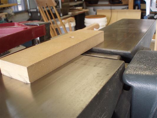

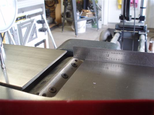

I have spent another three or four hours in the shop playing with the jointer today and made not one bit of sawdust. Furthermore, I enjoyed every minute of that time and despite the fact that I have been using the same jointer for over twenty years, I learned a lot.
What I know about using and maintaining the jointer is a culmination of information gathered over the years and apparently that process has not yet ceased.
I was doing this because of questions that arose in my mind about statements made in this and other threads regarding the jointer. Today it mostly involved comments about needing special equipment to perform a good jointer setup.
I believe it can be done with a block of wood, an allen wrench and a six inch steel rule.
But before I stick my nose out too far, I would like to get some feedback from the Shopsmith jointer users here on the forum.
Two questions that I need answered and I would appreciate input from several people - a consensus if you will.
1. With the infeed and outfeed tables set at exactly the same height (in the same plane), what is the width of the opening between the two tables? Mine is just a tiny, tiny bit less than 1 1/2 inches. Two pieces of 3/4" MDF, sandwiched together, will not fit in the opening without a bit of pressure.
2. When the cutter head is positioned so that a cutter blade is at the "top of rotation", how far is the sharp edge of the cutter from the edge of the in feed table? Mine is just a skosh less than 3/4". In other words the cutter head is centered directly below that opening.
If these observations are universally true, then the installation of sharp blades can be completed using nothing more than the tools previously mentioned and the blades will be within .002" to 004" inches of the same height.
[ATTACH]15229[/ATTACH]
Block of MDF to level infeed and outfeed tables.
[ATTACH]15230[/ATTACH]
One cutter head at top of rotation.
A short video of the low tech blade height check procedure that I have used. No dial gauge required. Ruler is expected to move about 3/16" with each blade contact.
