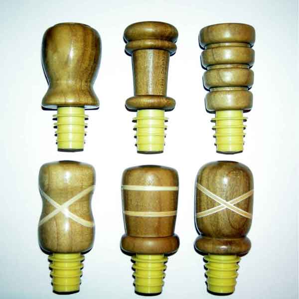

I am making bottle stoppers for my office staff’s Christmas presents this year, and they are proving to be a lot of fun and pretty easy (see above). The necessary materials are:
  • A block of wood approximately 1½” x 1½” x 2” long. Most woods will do, but lately I have been using poplar, available in short lengths at my local Home Depot. The dark green and the green and white striped pieces are quite pretty. I have ordered some cocobolo, bloodwood and bocote to try as well.
  • A mandrel or pin chuck to hold the wood as it is being turned.. Although you can turn the stoppers between centers (and probably will need to do that with soft wood like redwood), I much prefer using a pin chuck. I have found it to be very satisfactory for this kind of turning, and I don’t see any advantage to using fancier (and more expensive!) mandrels. I have attached information about making and using a pin chuck.
  • The actual stopper plug. This usually consists of a cork or silicon plug attached to a wood or metal dowel that is then glued to your turning. I like the silicon stoppers from Penn State Industries (http://www.pennstateind.com/store/bs5.html). Note that the pretty wood is not included, only the stepped dowel and the slip-on silicon seal. Contrary to their instructions, the silicon piece does need to be glued to the dowel…I use Gorilla Glue.
After turning, I finish the wood with friction polish or Crystal Clear Krylon spray.
Have fun!
--Bob

Thanks! That really a neat idea.
I'm not near so creative -- I've been using a plain old fashion "jam chuck", i.e. a piece of wood (1/2" dowel works)tapered to fit well up into the 3/8" hole of the stopper on one side and my chuck on the other. I just jam the bottle stopper blank on and it usually stays there -- usually.
By the way, very nice looking stoppers.

rflaaherty, One question, are the stripes, painted, decal, or inlay? Either way they sure look nice!!!

I've been looking at the "X's" on the bottle stopper. I often laminate stripes into my pen turning, but the "X's" stumped me. I'm thinking you laminated some thin sheets into the blanks, but I'm not sure how. All I can figure is that:
1. Cut the bottle stopper blank into a rectangular block
2. Prepare some contrasting stock into 3/32" sheets
3. Cut the bottle stopper blank at 30 degrees
4. Glue in a piece of the stock from 2
5. Cut the laminate from 4 at 30 degrees (this must be tricky to make sure the X's line up properly.)
6. Glue in a piece of the stock from 2
Am I close??

Thanks for your comments. These are actually laminations, twig/al, and greenvilleguy is on the right track. And yes, alignment can be tricky, but I have made two jigs that are very helpful. I am in the middle of treating a local flu epidemic right now, but I hope to have some time to upload more information here next week.
