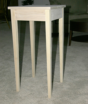

photos of the table
Here are a couple of photos of the table.
This was my first try at mortise and tenon. It is a stand for a little water cooler. I still have to do the final sanding and haven't decided how I am going to finish it yet.
JeffG
JeffG
- table.jpg (68.43 KiB) Viewed 15918 times

Thanks Nick
Well guilty of storing the wood vertically on the garage floor. While the floor was dry, it has been raining for a few weeks here.
I also glued the top to the table and screwed it in place. The wood was already split prior to that.
If I seal the wood with an enamel paint, will that prevent or reduce later wood movement and further cracking?
I am glad that I am learning on small projects with cheap wood.
JeffG
JeffG
I hate to be the one to tell you this, Jeff, but if you glued the top to the aprons what you've got is more of a learning experience than a table -- a nicely crafted learning experience, but a learning experience nonetheless. It won't matter how you finish it; nothing will keep the wood from moving and splitting further. The checks you're seeing now are just the beginning. Read the file; you'll be glad you did. There's stuff in there that it took me 20 years to discover.
