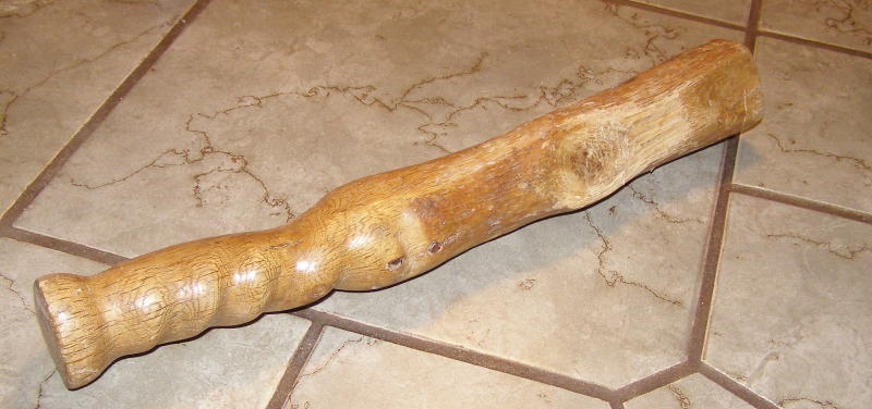

However, about 30 years ago I picked up a small piece of Oak firewood from the firewood stacker, ground off a protruding limb and started using itas a mallet. The remaining knot provides an impact resistant striking zone. It is a little light weight for many tasks and it might work better to have some contour such that the strike zone extends past a line through the handle. I have beat the crap out of it using it for more demanding hits than it is sized for but it has been a trusty tool for a long time. I have a similar but larger piece of Black Locust with a bend in it (where the knot protrudes) set aside for making a bigger mallet.

deec wrote:Ha! Yes, I thought as much. I was mostly just making a segue to the music wood topic.
However, about 30 years ago I picked up a small piece of firewood from the firewood stacker, ground off a protruding limb and started using itas a mallet. The remaining knot provides an impact resistant striking zone. It is a little light weight for many tasks and it might work better to have some contour such that the strike zone extends past a line through the handle. I have beat the crap out of it using it for more demanding hits than it is sized for but it has been a trusty tool for a long time. I have a similar but larger piece of Black Locust with a bend in it (where the knot protrudes) set aside for making a bigger mallet.
[ATTACH]15344[/ATTACH]
I have been known to use a branch as a mallet myself. Even a rough piece of firewood. Not sure if it was necessity or laziness!:D
