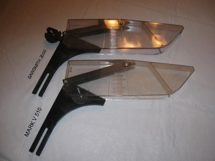

2.Is the top blade guard that’s supposed to be used with this thing interchangeable with any of the Mk V guards? I've temporarilly misplaced the gaurd from my 510 since I had to pack up a bunch of stuff to make room for my daughter's birthday party...long story.

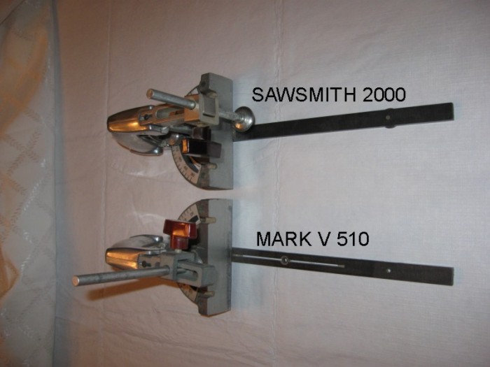

1. You will notice that the miter bar for the Sawsmith 2000 lacks the slot and tapered screw arrangement found on the 510's miter bar. Therefore it cannot actually be locked into place like you can on the 510's miter gauge.

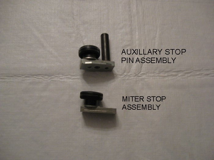

The Sawsmith came with two sliding Tee Nut assemblies. One that can be locked into the table's miter slot behind the miter gauge to help keep it in place. The second assembly has a pin which can be used on the cut-off end of the work piece during angled cuts in the "Radial Arm Mode" - see pg 55 in the Sawsmith manual.

2. The upper saw guards are similar with several common parts. The dimensions of the riving knife and its slot are the same. The main difference is the location of the anti-kickback cams. On the 510 they are located under the clear plastic cover. On the Sawsmith the cams are located behind the cover. In addition the Sawsmith cams can be positioned up and out of the way. It is necessary to move the cams to this position when making a "Radial Arm Mode" saw cut to prevent the cams from engaging the workpiece when returning the blade carriage at the end of the cut. Again this is covered in the Sawsmith manual.

Looks like I'll have to improvise a guard to make this work. To eBay!
