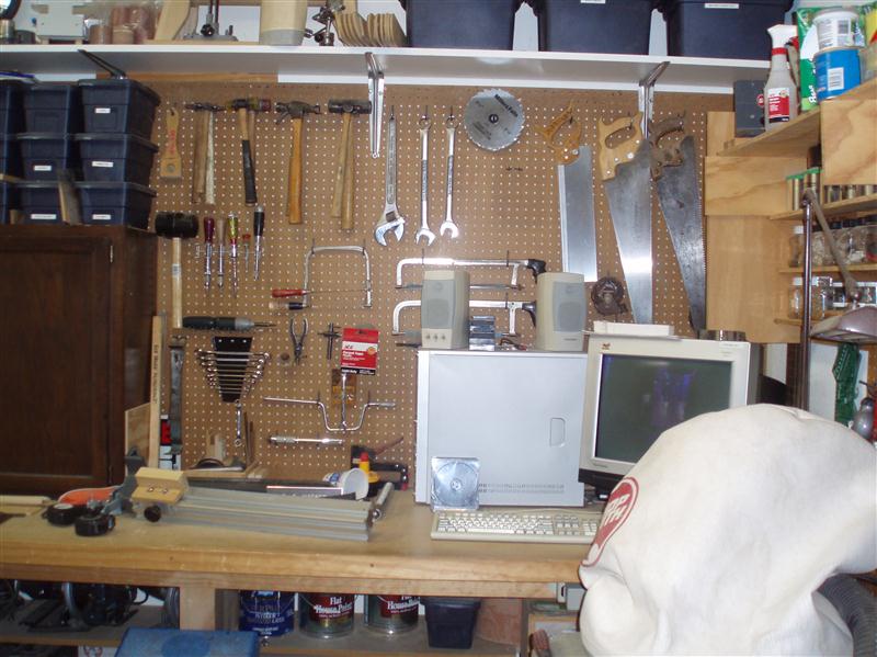

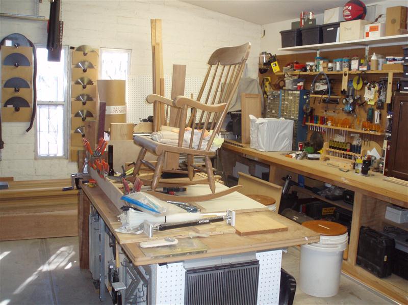

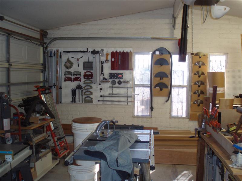

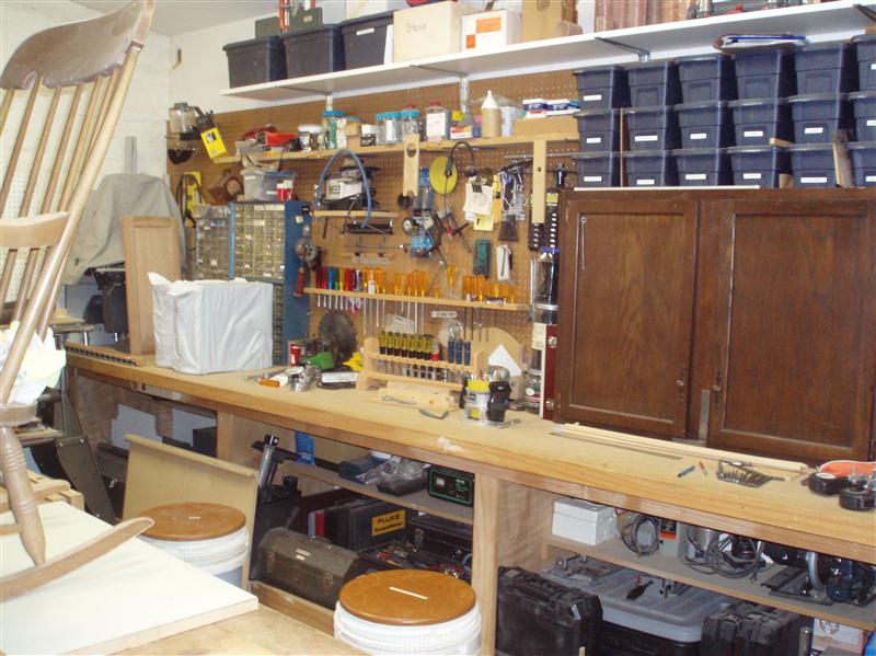

Fresh photos, ask and you shall receive. However, all these photos do is show how cluttered it gets if I do anything there.mbcabinetmaker wrote:Dusty I think some fresh photos of the area would help in making the diagnosis.
Shop footprint has not changed in a long, long time. The walk around bench is too heavy to move and the bench along the wall is attached to the wall (built-in if you will).

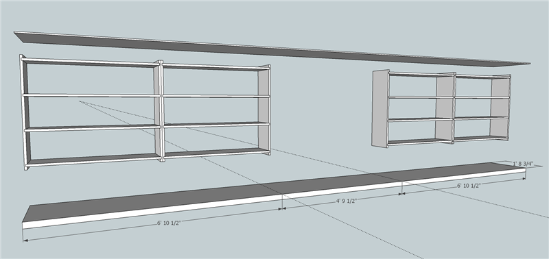

This sketch is intended to show where I think I am headed. I took the advise to lift the cabinets off the bench top. I will hang them with French Cleats. I left the area in the center so that I'll be able to hang the handsaws (5) and a few other tools.
[ATTACH]15519[/ATTACH]
The upper shelf is actually at the height of the new cabinets (that is - it is wrong). It will be lower and will NOT span the area between the new cabinets.
There will be a face frame. Doors - maybe.

Deep enough for double sideed peg board?dusty wrote:Thanks for the comments Ed. Yes, there is room for peg board and cabinets and I shall probably end up with both.
