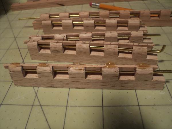

mbcabinetmaker wrote:Paul how did you fill the saw kerf after inserting the pin?
This is a hinge I developed and posted as a blog on lumberjocks. I thought it must be old news and invented thousands of times before, but it has become one of the most favorited blogs on the site. Who knew?
The slots are filled with a little spline, either separately or all at once as below. Let the glue start to set (I use hide glue so that means about a minute) and pull the pin. If you do the one in the photo you just trim out the waste bits with the bandsaw.
[ATTACH]15617[/ATTACH]
The way I originally used it, it has even more features. For instance, on a box it will stop just past 90 degrees and you can have it fully functional and still remove the lid if you leave the lower splines out. Here's a link to the blog. It is in two or three parts. You can move to the next part by clicking the next title at the top right of the page. http://lumberjocks.com/shipwright/blog/series/4096

shipwright wrote:This is a hinge I developed and posted as a blog on lumberjocks. I thought it must be old news and invented thousands of times before, but it has become one of the most favorited blogs on the site. Who knew?
You don't have to be a member to look, just to comment.
Paul M
OK... I was thinking 180 degrees off.
I was visualizing cutting a deep kerf for a spline down the back leaving only the front (round) part intact then splining and trimming out. I was picturing a box side etc. with a longish tenon that would serve as a spline. I guess that would work OK???
That picture clears things up.
