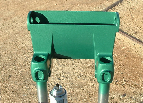

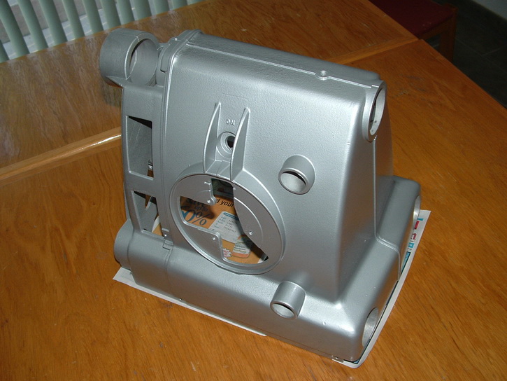

got a little crazy today with the blaster
Luckily the desert winds were in my favor today. I thought the headstock casting would be an easy "sand and paint" but alas, no. The paint was flaking into little chips so I just dug out the Horrible Freight hand held sandblaster and gave it what fer. The desert wind carried it away from me off into the desert to lie with the rest of the sand. Will paint the headstock tomorrow if the winds die down.
Also painted the end piece cause it was ready. Pics below.
- SS END PIECE PAINTED AND HEADSTOCK.jpg (133.39 KiB) Viewed 1698 times

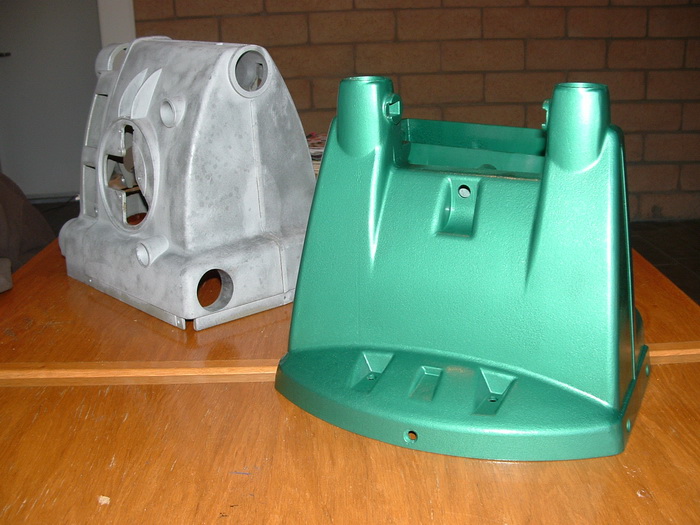

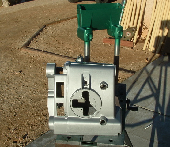

No Way yer NUTS!:)wiredone wrote:Luckily the desert winds were in my favor today. I thought the headstock casting would be an easy "sand and paint" but alas, no. The paint was flaking into little chips so I just dug out the Horrible Freight hand held sandblaster and gave it what fer. The desert wind carried it away from me off into the desert to lie with the rest of the sand. Will paint the headstock tomorrow if the winds die down.
Back at it today the winds have dyed down again.
Seems like they were made to order the other day.
I try and do at least one piece a day, no hurry.

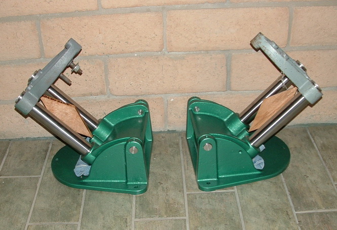

- SS grny pnt 1.JPG (132.2 KiB) Viewed 1681 times
- SS grny pnt 2.JPG (137.24 KiB) Viewed 1675 times
- SS GRNY PNT 3.JPG (133.16 KiB) Viewed 1673 times
- SS 10E FURN 1.JPG (132.07 KiB) Viewed 1675 times

Please tell me those are not 10ER tubes!:eek:wiredone wrote:Back at it today the winds have dyed down again.
The last picture is of a different project, making furniture from 10E leftovers.
The end result should be awesome.............
Okay, Those are not THICK-WALL tubes!
I have many many thick way tubes, but these are thin walled.
(I'm not that crazy.)
