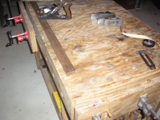

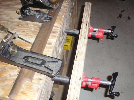

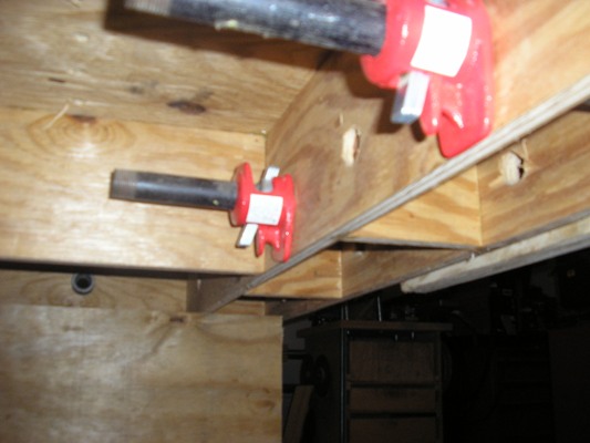

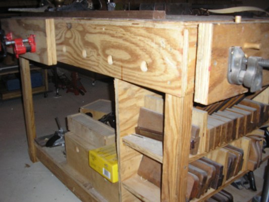

Here is mine in a couple shots.
Cheaply made but dead flat. 3/4 ply top. Ribbed torsion box construction. 3/4 pipe clamp holes spaced throughout and able to pass a pipe all the way through.
48x29x33 1/2h. Holes for dawgs spaced every 2.5 inches. Dawgs are 1/2 inch hardwood. Holds up to my obvious planing needs.
[ATTACH]15732[/ATTACH]
[ATTACH]15729[/ATTACH]
[ATTACH]15730[/ATTACH]
[ATTACH]15731[/ATTACH]
Some tools are set for 33 1/2 high. Thats the tablesaw, router table (doubles as TS outfeed and this bench doubles as TS support for ripping plywood.
