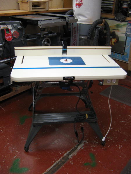

I'm looking for a new router set up as the melamine on my Rockler router table is chipping off. (I tried putting on a new formica top but it turned out pretty bad.) I'm looking at Bench Dog, Kreg, MLCS. I know lots of people make their own but I'm just not interested in building a table.
My shop is small (12 x 14). I use my SS as my main tool. I don't have another table saw for example. I don't have room to set up a second unit dedicated to routing or I wouldn't do this. I mount my Rockler to a BD WorkMate like this when in use.

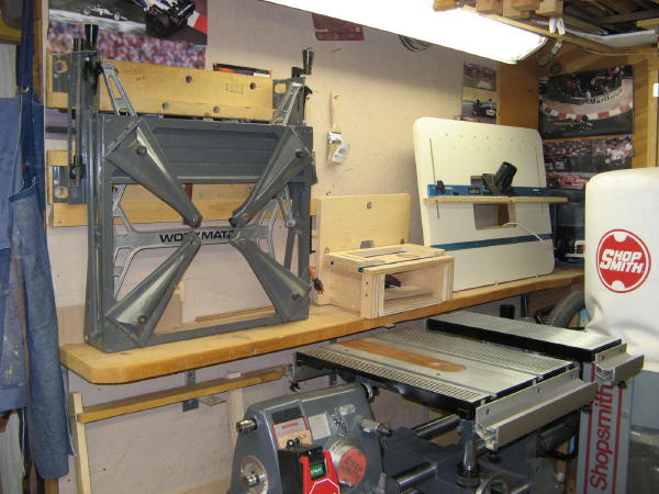

When not in use they go on the wall and I get the floor space back.

1. How long to change over to routing from another operation?
2. It looks to me as though I don't have to remove the head stock to use the router set-up but could someone verify that? Then if you leave the head stock on how difficult is it to lift into position? (I don't have one of those fancy lifts.)
3. While I see advantages to have the router over the work I used to having the router mounted under the table. Has anyone mounted a router under a SS table? How'd that go?
4. The fence arrangement sure seems odd and perhaps difficult to set up, comments on the fence.
5. If you use a router regularly, can a SS unit be your only router table.
I'd appreciate any opinions positive or negative and the time you took to read and reply.

2. You can leave the headstock on, but you'll need to slide it way to one end, which makes it a real "Wheaties job" to lift. I don't do this since I have a dedicated 'shorty' stand for my OPR.
3. Under-the-table can work on the early-style independent OPR's, but it doesn't work on the modern way-tube-mount OPR setups. The worktable tie-bar is in the way.
4. The factory fence is not the strong point of the OPR table. I've made my own sleds and fences, and just occasionally used the factory fences.
5. I think the thoroughgoing craftsman will want both an OPR and an under-table router setup. I only have the OPR for now, still thinking about a conventional table scheme in the future. For my style of projects, the OPR is enough, but the lack of an under-table router has influenced some of my decisions on joint styles, etc.

1) Not that long. Maybe 2 or 3 minutes with practice. Its about the same length of time it takes to do most changeovers that require the waytube clamp.berry wrote:
Anyway I'm here to ask questions and get opinions about ShopSmith's router unit.
2) Nope, headstock stays on. It can be tough to lift the headstock into place, but you will have to decide for yourself what is too much. Realistically speaking, you need the headstock in the drill press or slightly higher position.
3) As noted, it won't work under the table by default. Some people have modified their floating tables to serve as router inserts (similar to how the BT3000 saws do it). If you have a 510 you can also get extra rails from people who went to a 520 and then make your own insert.
4) Its not too bad...just use a straight board to get it aligned.
5) Depends on who you ask. If you have an under mount setup as well then definitely yes. If not, then its probably like any other shopsmith thing - you can choose to deal with the "quirks" to compensate for the small space and such.
