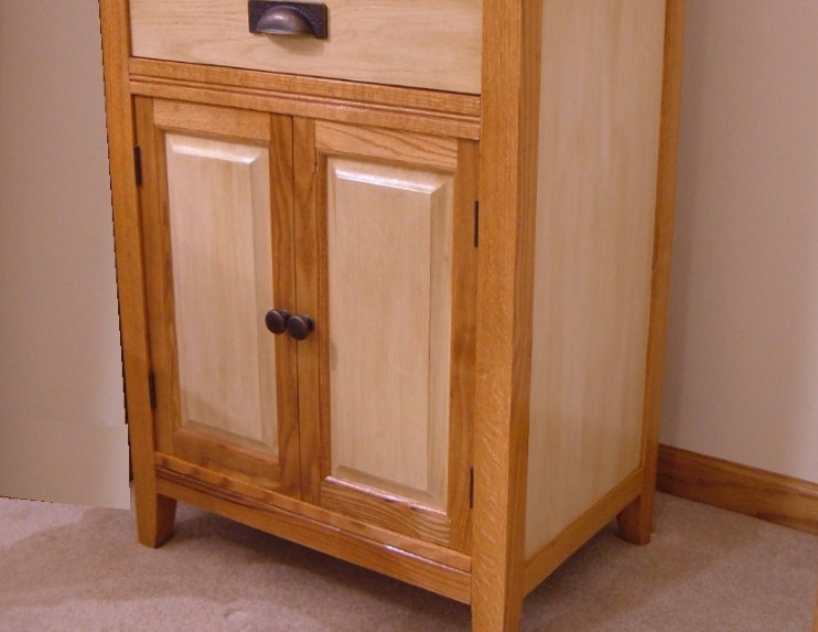

Why wasn't I told this before I bought a door makers shaper bit set??? (cheap one..Harbor Freight) Why wasn't I warned in the shaper fence instructions??? Why didn't some alarm go off when I ran some oak sticks through it???
Am I now in trouble with the separate tool police? Should I get rid of the evidence? Yikes![ATTACH]16098[/ATTACH]
