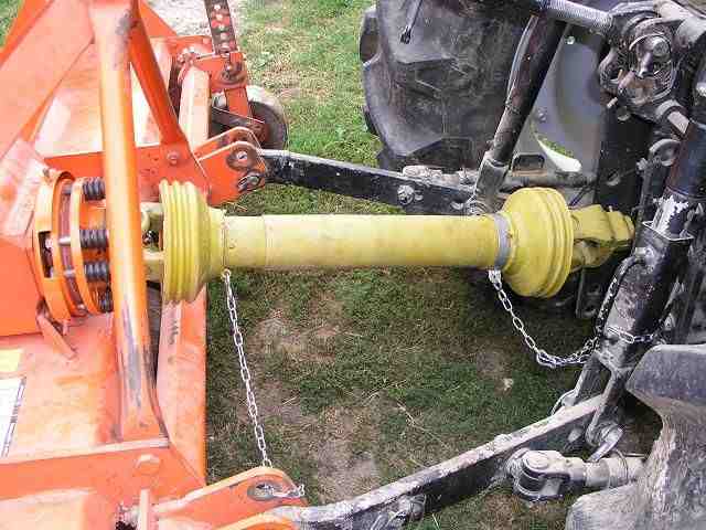

On most farm machines that are ran by a tractor they are most often coupled either by flat belt (fairly obsolete today) or PTO shaft. A tumbling bar with a universal joint on each end. Normally one end stays attached to the implement and is coupled to the tractor by extending the other end (telescopes in the middle) and sliding it over the spline shaft on the tractor. There are several different ways to keep the end on the tractor shaft.
This is typical:
[ATTACH]16458[/ATTACH]

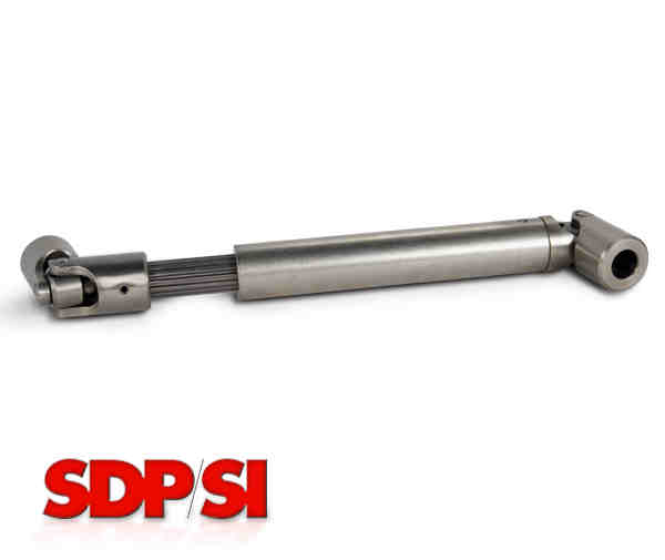

Something like this one should work OK and is much much smaller than the one on the tractor. These can also be made up with safety slip clutches in the line. In using something like this you would add a hanger hook to the SPT so you could swing the shaft aside and hang it off to one side when disconnected:
[ATTACH]16459[/ATTACH]

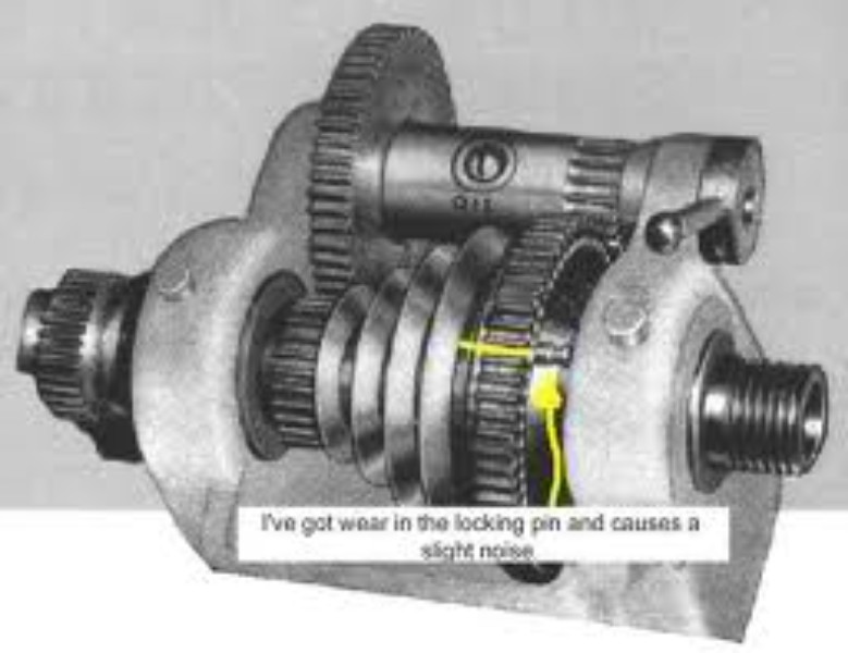

One thought was a simple connect / disconnect (as opposed to a friction clutch) of 2 disk about like the small faceplate. One, the driven disk permanently mounted on the bandsaw shaft would have a series of holes like an index plate and the other (driving disk) a single "poppet" lock pin (correct term?) like the lock pin used to direct drive a metal lathe arbor when the "back gear" is disconnected (most common status). In this case the holes in the driven disk should be a fair amount larger the the diameter of the lock pin to allow for tiny alignment errors.
In this picture of a small metal lathe drive line I found Googling, the arrow points to the poppet pin you push in or pull out to couple / uncouple the large gear from the belt pulley to the left of it. I'm sure of course that those who are familiar with metal lathes knew when I started what I am talking about but it can be hard to describe to those not familiar...
[ATTACH]16467[/ATTACH]

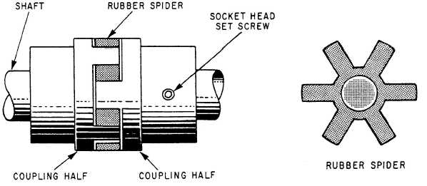

Even simpler would be a simple Lovejoy coupler and mounting one half full time on the headstock left stub and the other on the bandsaw shaft. Then to disconnect you would loosen the set screw on the bandsaw half and slide it and the spider to the left and re-snug it so it could not move to the right from vibration. The downside is needing a tool but it would be simple and would be ideal for minor alignment variations. BTW, the halves can be bought in different shaft sizes for each half.
[ATTACH]16468[/ATTACH]
