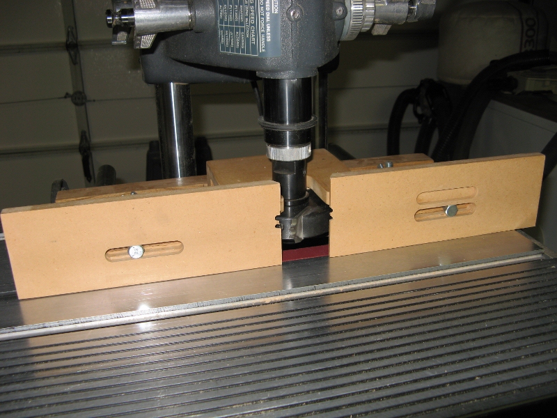

I am a lifelong woodworking hobbyist and over the years I have accumulated a lot of woodworking tools & toys but have had my ShopSmith (SS) for about 6 Months. In that time I have Shop built several jigs and woodworking aids.
To answer your question. Based on my experience I would buy a manufactured jig based on need and safety. I would make a shop built jig on ability to safely make a jig that would preform the intended function.

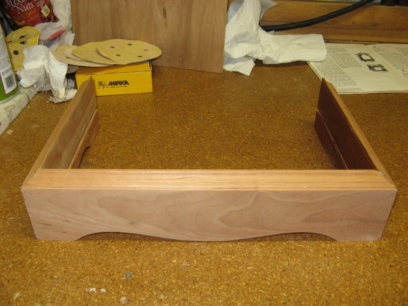

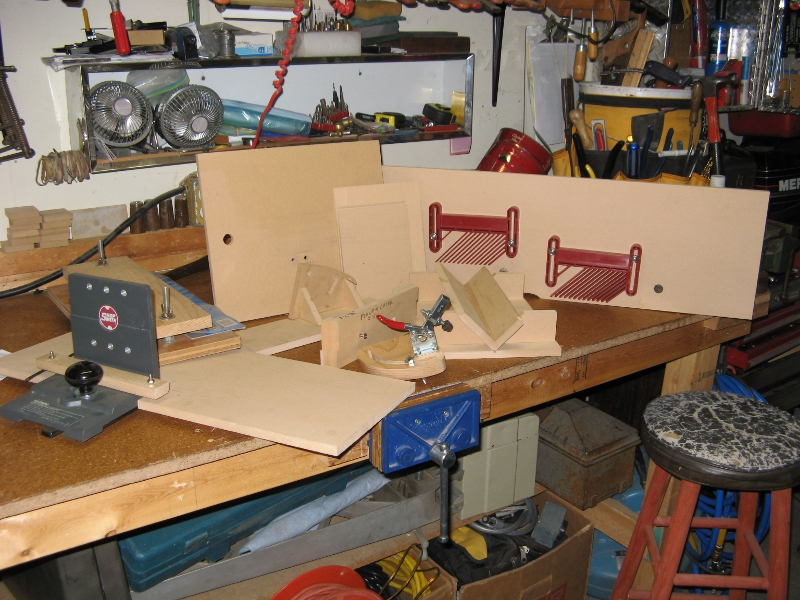

I am attaching a picture of a shop built molding head jig and a completed function of the jig. The third picture is of various shop built jigs from the past 6 mounts.
[ATTACH]16498[/ATTACH]
[ATTACH]16499[/ATTACH]
[ATTACH]16500[/ATTACH]
I know this may not be the definitive answer you were looking for but this should give you some incite on making your decision.
