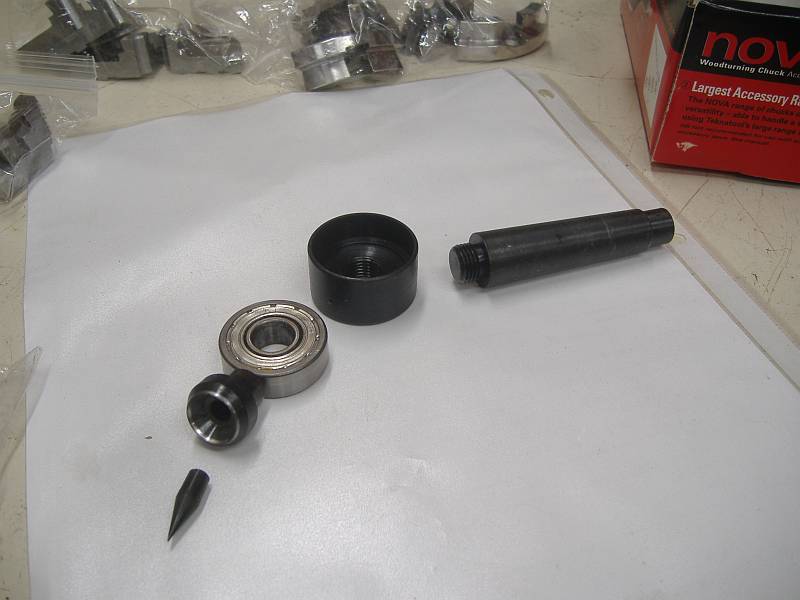

Since Tom has brought it up I took my live center apart today so I could see what it looks like inside. Thought I'd share it with you.
[ATTACH]16576[/ATTACH]
