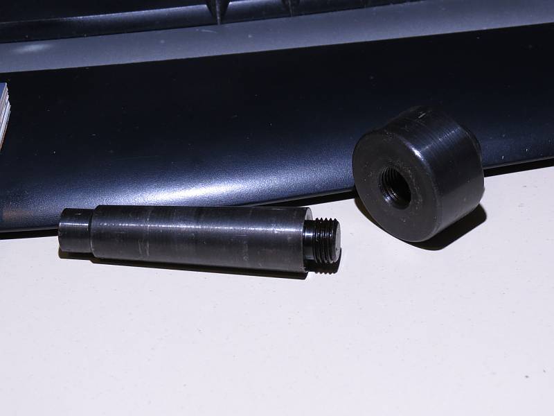

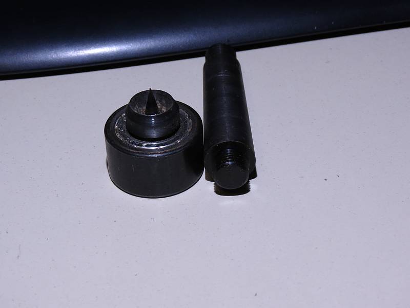

Hi,
The live center that I have from shopsmith comes apart as shown below. The thread is 1/2-20.
So far this is the only one that I know about. My plan calls for using the center without the MT2 portion, instead using a bolt and threading the forward portion on to the bolt.
[ATTACH]16560[/ATTACH]
[ATTACH]16561[/ATTACH]
In case anyone was confused by earlier posts this should clear things up.
