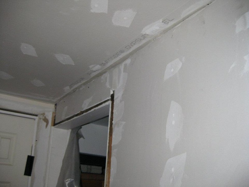

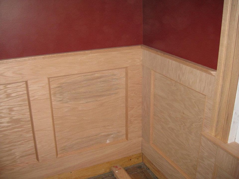

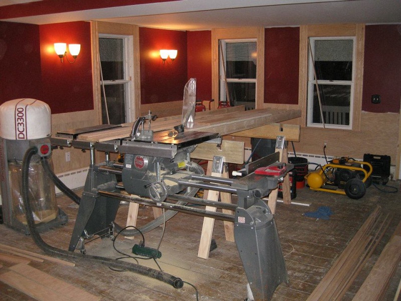

We chose to do a custom wains coating on the bottom 40 to 42 inches of the wall, depending on the side of the room as the floor is not square.
[ATTACH]16591[/ATTACH]

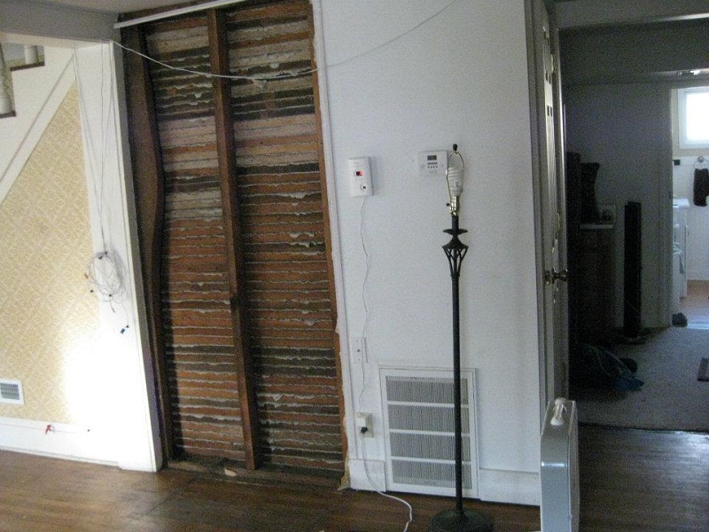

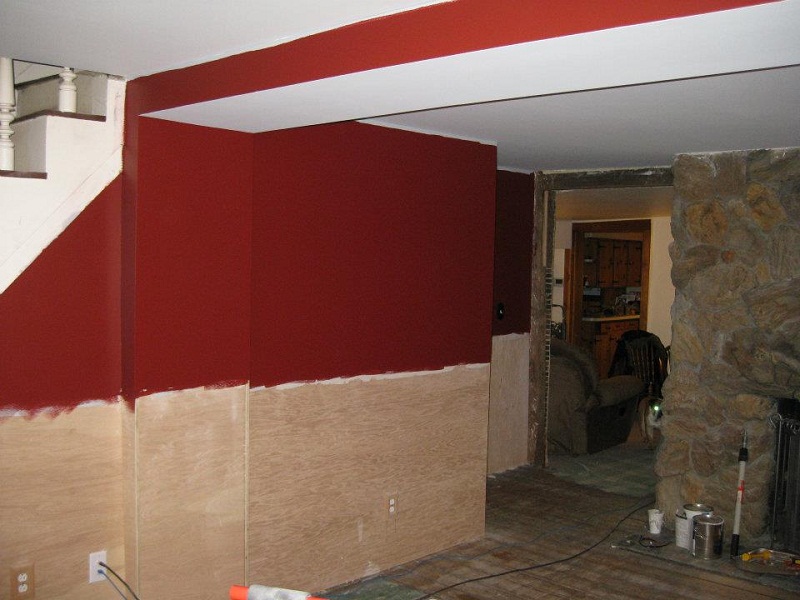

My issue arises from a corner closet that was built to house an air handler for our central air. It is in the corner of the living room and the door doesn't match the rest of the home (6 panel fake board door piece of crap). I want to create a hidden door if possible, so it looks like a bookshelf on top of the wainscoating. It will have a book to pull to release the latch on the inside to get it open to access the air handler as needed.
Ok here is picture or two of the closet
[ATTACH]16592[/ATTACH]
I already moved the Cold Air return to the other side of the unit placing the grate on a wall in another room.
[ATTACH]16593[/ATTACH]
This is a picture of how the close the closet was built to the door frame entering to our sitting room.
Here is a picture of the wall minus the finish boards for the wainscoting but with the vent moved.
[ATTACH]16594[/ATTACH]
Ok so the problem arises that the door must swing out. Every door I have seen online either swings in, or does not have moulding on the outside at all that would interfere with the swinging action. Because of the moulding rail, if it swings out on hinges the moulding would literally have to be removed as it would contact and try to dig into the wall. I don't want a seam to show as I want it to continue the look of wainscoting all around.

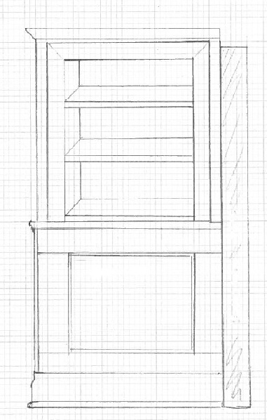

I have several options and I am just trying to sort which is the best.
First I could do a full bookshelf and say heck with the wainscoting but I want to continue the wainscoting look around the room so that option is at the bottom.
Second I could just put a nicer door back on. Don't really consider that one an option right now. I want something unique and challenging.
Third, I can make the bookshelf pivot above like any other outswinging hidden door and then unlock the bottom portion and just lift it out of the way. It could just be latched into place and removed completely
fourth, i can use sever 30 inch heavy duty slides and the whole thing slides out and you just step over the slide and work with the door behind you.
Fifth, I can use slides to slide the door out a few inches. then unlatch one side and it swings open on hinges.
I am sure there are more ways to accomplish this and probably a better one.
Here is a quick drawing of what I want the door to look like when done.
[ATTACH]16596[/ATTACH]

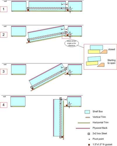

This looks like it could work.
http://www.instructables.com/id/Hidden-Door-Bookshelf/
[ATTACH]16605[/ATTACH]
- F607GDVF82EU3UH.MEDIUM.jpg (16.95 KiB) Viewed 3594 times
Very interesting project at Instructables. At least one thing from that project that could be applied here is the placement of the hinge. Instead of putting the hinge at the traditional edge of the door, put it at the top and bottom of the door, in from the edge.

Slightly overlap the trim with the door. The door on the short side of the hinge will swing in, so overlap the trim from the wall over the door. The door on the long side of the hinge would swing out, so overlap that trip over the trim on the wall. When closed, they come together.
