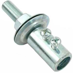

There is a possibility (I have not checked yet) that the space between the headstock and bandsaw will be longer than the stub and bandsaw shaft are and if so I can just extend the bandsaw shaft as needed. I would likely make an extension like these motor shaft adapters below but with Allen setscrews and an un-threaded shaft with a long flat.
[ATTACH]16637[/ATTACH]
- temp motor shaft.jpg (8.65 KiB) Viewed 7348 times
