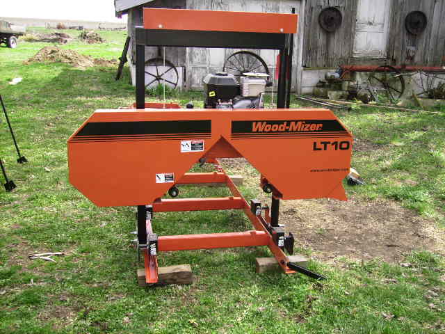

Slowly getting there...
Note: the blocks under the frame are just temporary support.
[ATTACH]16700[/ATTACH]

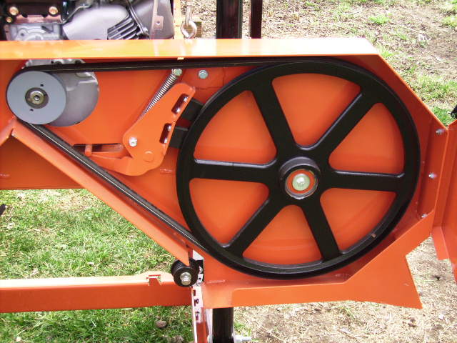

This saw has a couple of interesting ways that they do things. Notice that the Vee belt drive from the engine also serves as the bandsaw tire. The blade is a 1.25" wide blade and so the teeth never run against the tire.
[ATTACH]16701[/ATTACH]

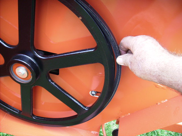

Also interesting (I thought) is that the Vee belt / tire on the idler wheel runs loose on the wheel.
[ATTACH]16702[/ATTACH]

robinson46176 wrote: . . .
Bet that makes getting it on and off the pulley easier!:cool:
