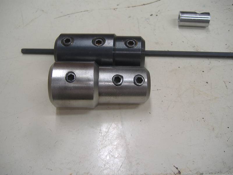

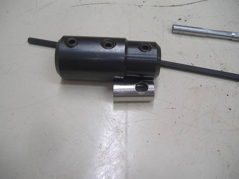

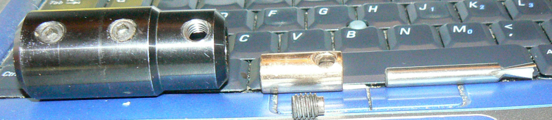

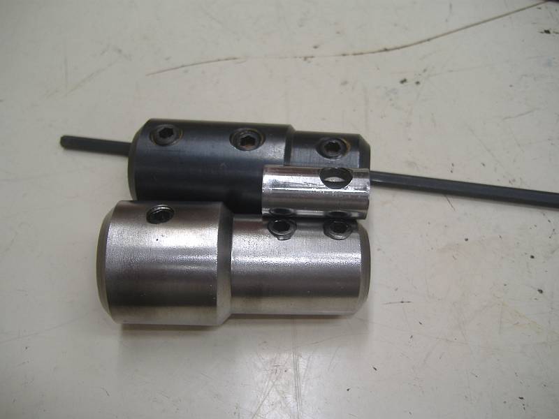

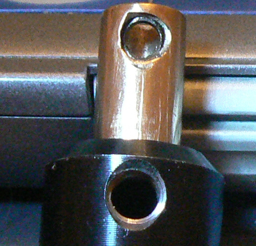

I'm going to post some pictures now so you may need to go back over this a few times to "get" what is/was going on. The first picture shows the two different chucks I have.
[ATTACH]16728[/ATTACH]
Next are the two chucks with the adapter. From this you can see how the adapter would have two set-screw used, one to hold the bit and one to hold the adapter on the old chuck. On the new chuck only the single set-screw would have to do both functions. I'll explore more on that later.
[ATTACH]16729[/ATTACH]

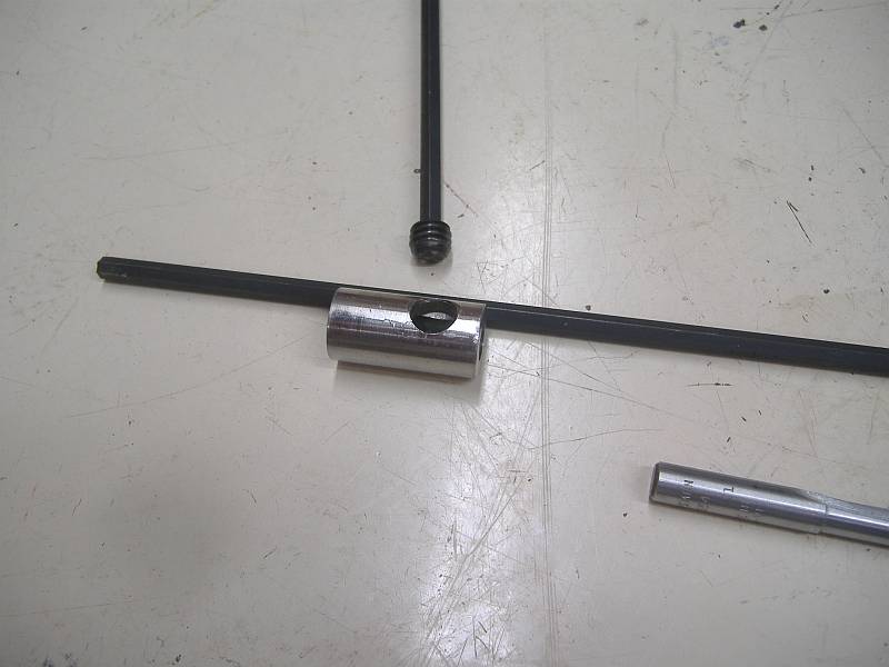

The next shot shows the adapter so you can see the step where the shaft hole and set screw intersect, just for your reference.
[ATTACH]16730[/ATTACH]

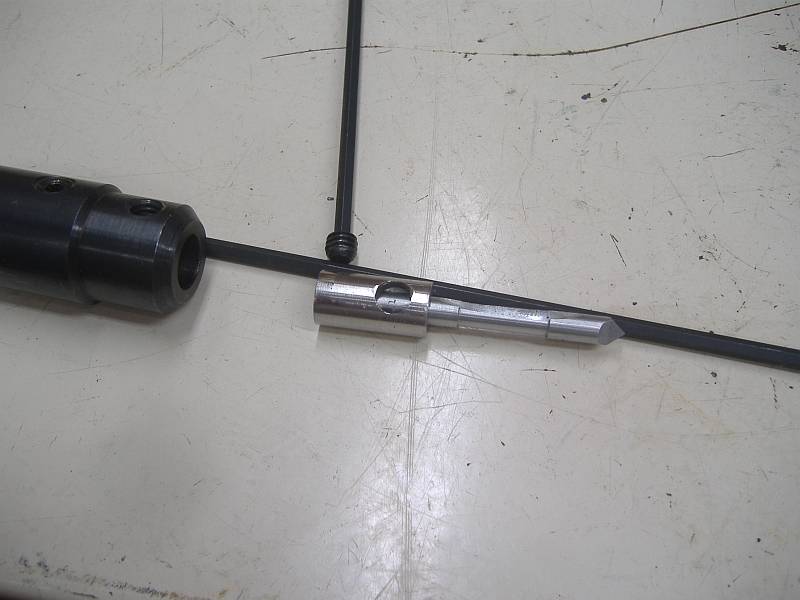

Now we can look at the black chuck and the insert in more detail.
[ATTACH]16731[/ATTACH]
From this you can see the adapter will be inset in the chuck and the second setscrew will not have a clean fit on the adapter. Just a little bit longer would have made this more universal.

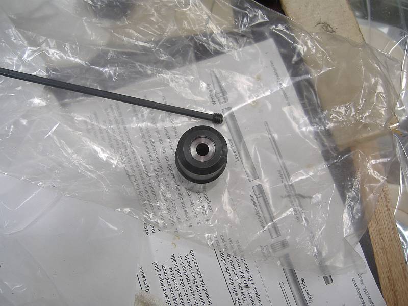

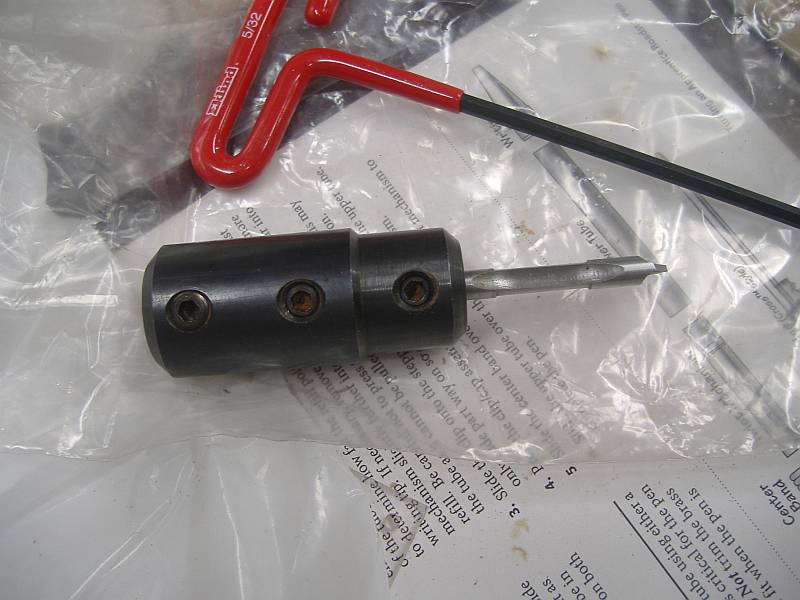

Here is a shot with the router bit in the adapter.
[ATTACH]16732[/ATTACH]
Adapter in chuck.
[ATTACH]16733[/ATTACH]
All together.
[ATTACH]16734[/ATTACH]

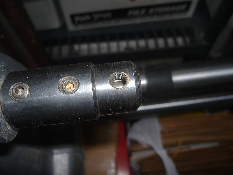

A peak into the setscrew hole
[ATTACH]16735[/ATTACH]
So would it work? Maybe?
And after looking at the adapter and new chuck I can see an issue with the setscrew that might be used as the holder for the adapter.... anyone else spot it?

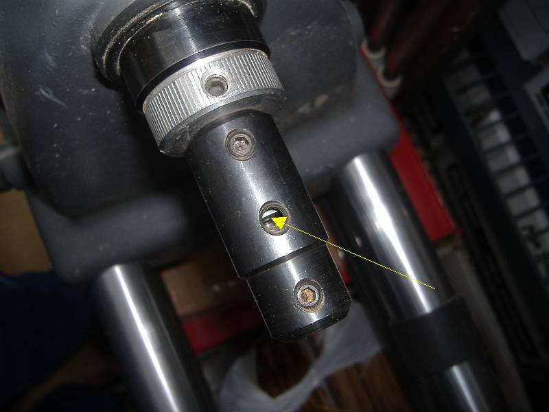

For the moment lets assume you all know this and the photo is no surprise.
[ATTACH]16736[/ATTACH]
Note where the end of the shaft is and where the setscrew hole is....mmmmmm.

Great? minds think alike!

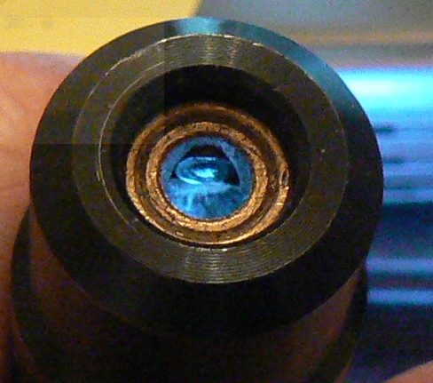

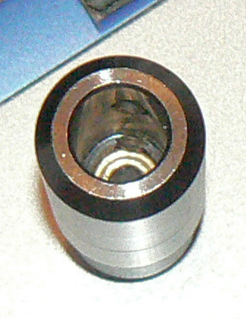

The bronze part is actually two parts. A 1/2 x 3/8 x 1 and a 3/8 x 1/4 x 1 bushing.
Notice the set screw - it is a half dog 'point'.
[ATTACH]16737[/ATTACH]
The bushings are drilled differently. The inner bushing has a hole that allows the set screw half dog 'point' to pass through it so as to secure the 1/4" bit shaft. The outer bushing is tapped with a continuous thread from the chuck(the tap was passed through the chuck threads when the bushing threads were cut).
[ATTACH]16738[/ATTACH]
Notice the set screw 'point' protrudes through the inner bushing.
[ATTACH]16740[/ATTACH]
The middle chuck screw just touches the outer bushing. Since the two bushings are closely tied to the chuck at the front screw, this screw does not actually do much.
[ATTACH]16741[/ATTACH]
