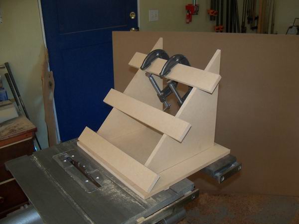

Hi Gene
This is the way I did 45's for the curio cabinet aka Oops! (see my avatar) on my 10ER. It is really easy to make quickly and very accurate.
[ATTACH]16803[/ATTACH]
Full details on how it's made and how it's used are in the construction album.
That project required extreme accuracy and this little half hour jig did the job.
Paul M
