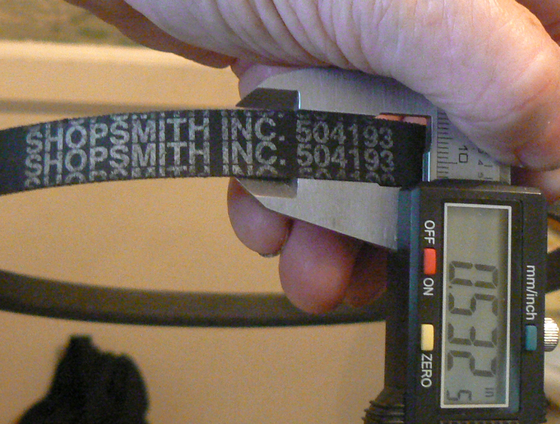

wiredone wrote:I called ShopSmith a few weeks ago and asked about the belts being different etc, and was AMAZED at the hostility I encountered.
That guy was just ANGRY when I innocently asked about the difference in the belts. He said it is a crowned belt and 1s .490 x 25.75"
and get this, "it's always been that size ever since they started making the Mark 5 in 1955!
His name was Dave and since he was nearly yelling and didn't even know when the ShopSmith Mark 5 was first made, I didn't buy the belt. Wrong size.
I just got mine from the guy on Ebay as per Bill Mayos recommendation.
Wonder where this came from?

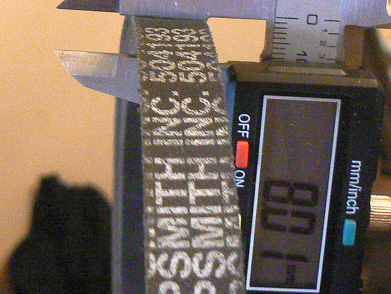

[ATTACH]16820[/ATTACH]
[ATTACH]16821[/ATTACH]
The calipers are indicating mm which is about .315".
But then, the part number has changed!
Back in 1963, it was part #3052.:D
motor belt width.jpg (461.94 KiB) Viewed 755 times
motor belt top.jpg (744.09 KiB) Viewed 760 times
