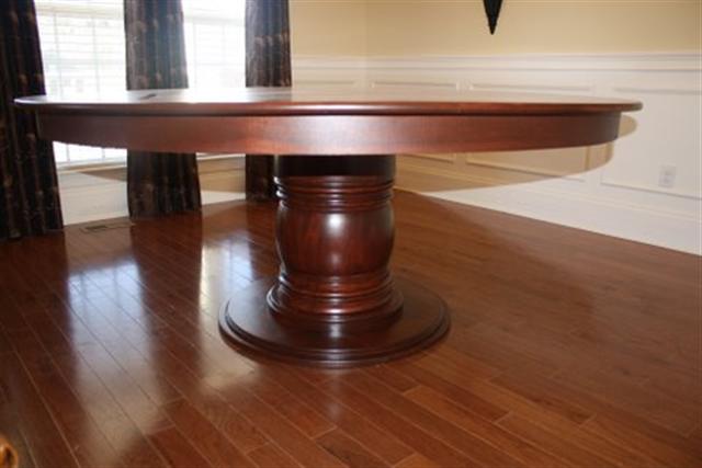

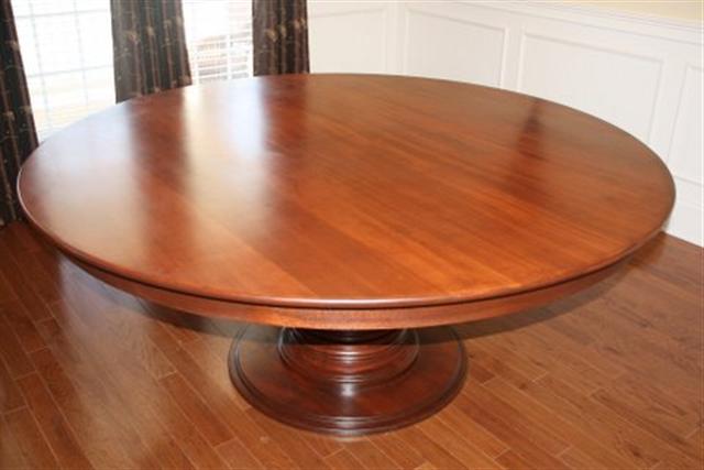

I bought a small Cobalt gravity feed from Lowes. I have friends that are constantly looking for a "better" equipment solution when better technique makes the most difference. If I had $1ooo+ for a trubine sprayer I would have one, but for the moment I'll make do with what I can. I don't think there will be much argument with the pics I attached.camerio wrote:Could you elaborate on that ?

Shellac sealer sprayed
Gel stain
Oil based stain sprayed
3 coats of GF Enduro water based top coat after solvents have evaporated from oil based stains
- 21-FINISHED 1.JPG (35.47 KiB) Viewed 1756 times
- 22-FINISHED 2.JPG (35.59 KiB) Viewed 1753 times

Thanks for your answer. We do not have Lowes store in our area but I may search at others.scollins wrote:I bought a small Cobalt gravity feed from Lowes. I have friends that are constantly looking for a "better" equipment solution when better technique makes the most difference. If I had $1ooo+ for a trubine sprayer I would have one, but for the moment I'll make do with what I can. I don't think there will be much argument with the pics I attached.
Gel stain
