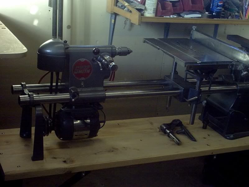

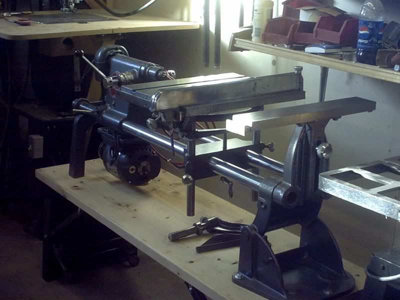

Post by mranum »
As I promised here are some pictures of my old 10ER revived. Sorry the pics don't really do it justice.
She works just awesome I might add, but then again I like old tools when they were built to last. Like my Delta Homecraft 1951 table saw, and my Foley Belsaw 12" x 6" planer thats a 1953 model if memory serves.

The pictures are there and are just fine. I have noticed that the pictures sometimes take a minute to download; be patient.:) It looks like it is in great shape and you have cleaned it up nicely!

Hi, mranum - That is one beautiful machine you have. You should be justifiably, very proud of your clean up - restoration. Your photos are also very good!
