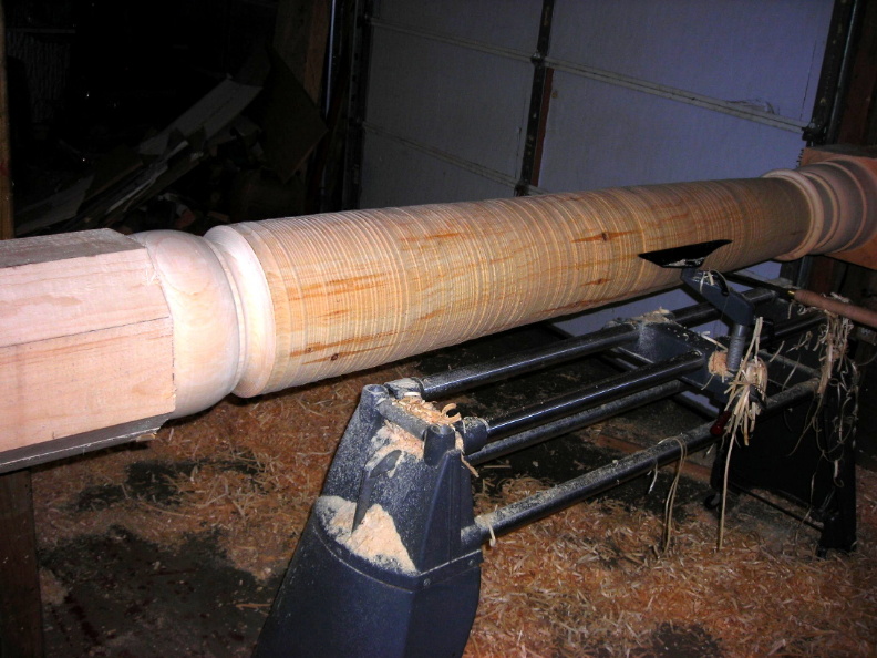

lmccown wrote:I am trying to build a boring jig for an aspen log lamp about 5" in diameter and 20 " long. Something that will keep it from moving while I use the Shopsmith to bore vertically. Is there a tool or does someone have a jig they use. The jig I am trying to build will act as a sled so both the head stock and the jig can move to accommodate different size logs. I am using a 3/8 14" bit. Lonnie
Here's what I did for a pepper mil that is 20" long. Drilled half way from each end to get the holes to come out in both centers. In your lamp, the holes don't have to exactly match - just enough to run a power cord through. Used the lathe with a chuck and a Forster bit with two 6" extensions.
[ATTACH]16840[/ATTACH]
[ATTACH]16841[/ATTACH]
Another way to deal with that problem is to saw the long cylinder in half and rout a half hole in each side before gluing together.

This looks like the way to do it. Thanks and those are awesome pictures. Lonnie

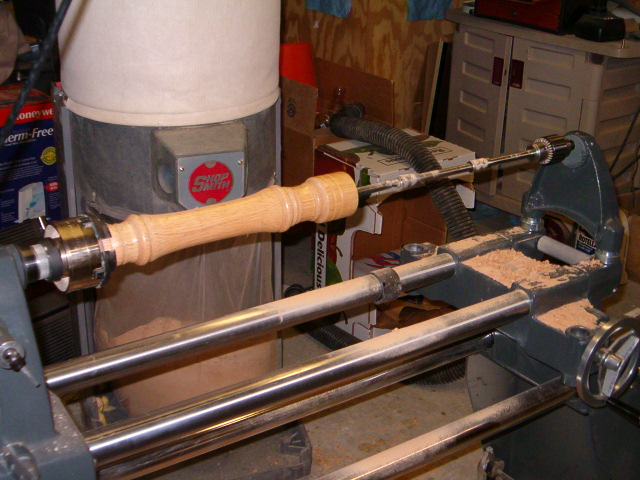

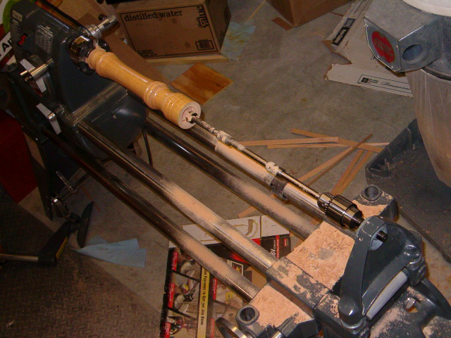

Log turning? or lamp chord bore
Post by mhebb1 »
I bored out a cup center to about 3/8" , chucked up my lamp stock between centers and ran a lamp auger up the middle.
I thought your title meant something like this. Hope the photo comes thru.
