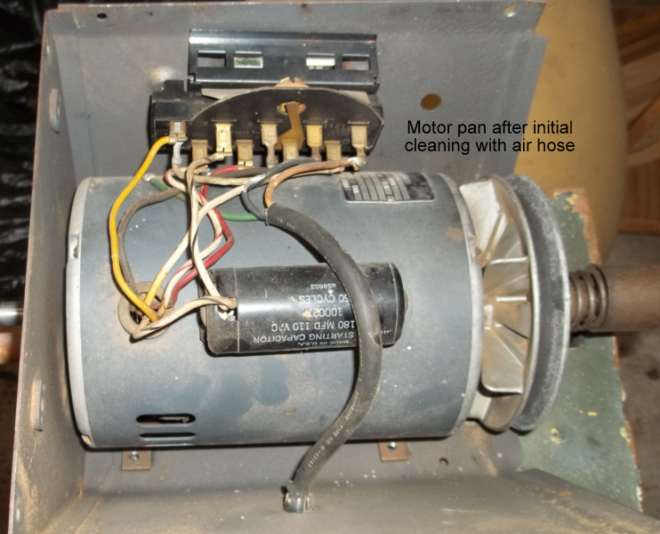

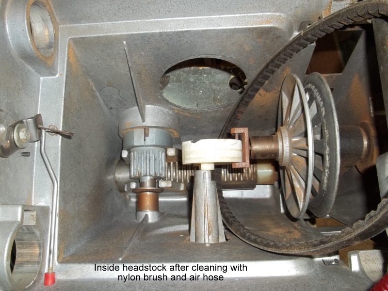

Finally had a little time today. It's raining, and that's always a good excuse for shop time. Here's what I'm finding in my "new" Mark VII.
Took a nylon brush and my air hose and cleaned the inside of the headstock/motor pan. There really wasn't that much sawdust inside the unit. I don't think this is from lack of use so much as the previous owner (and his wife) being pretty meticulous about cleaning.

However, closer inspection shows that the insulation on the power cord is bad. In fact, I was going to just wrap the exposed wire with electrical tape but the insulation was crumbling off in my hand. So, the unit gets a new power cord.

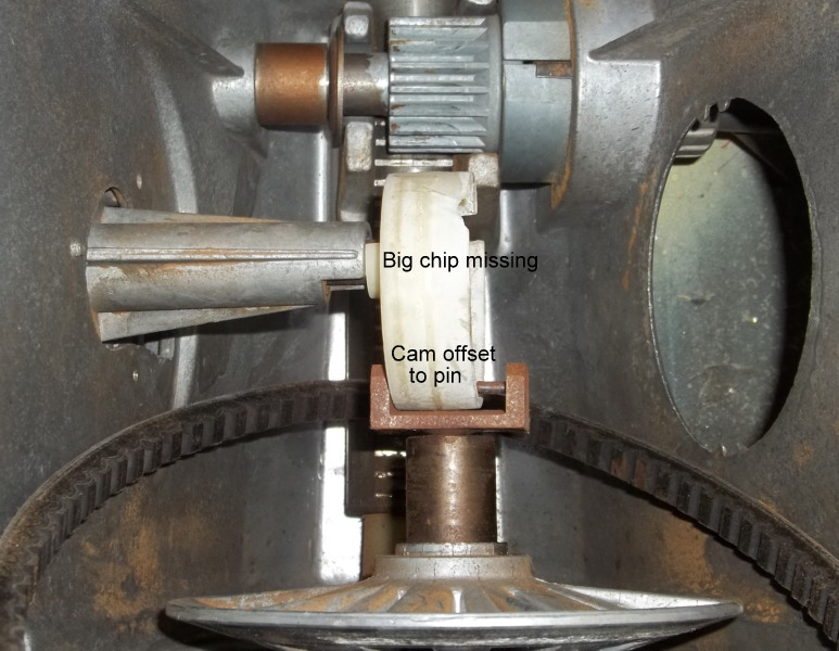

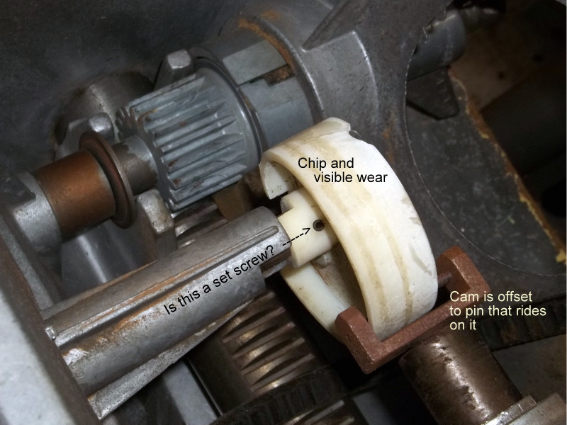

Not only does the speed changing cam have a significant chunk missing, the offset from the pin that rides in it to change speeds is so bad it barely is holding on the far side.
[ATTACH]17137[/ATTACH]
So my question is whether or not this can be moved/adjusted. It looks to me like this is the setscrew that would accomplish that.

fiatben wrote:Finally had a little time today. It's raining, and that's always a good excuse for shop time. Here's what I'm finding in my "new" Mark VII.
[ATTACH]17138[/ATTACH]
It's not a setscrew, it's a rollpin that is driven thru the shaft and speed cam
If you turn the eccenctric to the opposite side to tighten the belt, that may shift the idler shaft over, that's one of those things you'll just have to try and see if it moves it far enough.

Thanks
Good idea. I'm pretty open to any suggestions as this is all new territory for me.gchapman wrote:If you turn the eccenctric to the opposite side to tighten the belt, that may shift the idler shaft over, that's one of those things you'll just have to try and see if it moves it far enough.

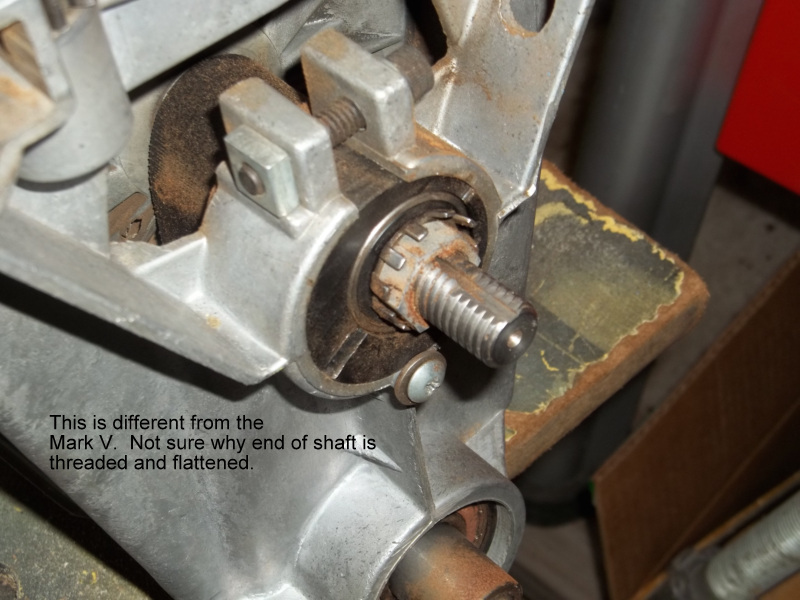

This is a bit different:
[ATTACH]17139[/ATTACH]
and I don't understand the purpose behind the threaded shaft with a flat.

That threaded shaft appears to be a standard feature. You can see the same on this one that I looked at here in NS.
[ATTACH]17142[/ATTACH]
Or at least you can when you blow it up:
[ATTACH]17143[/ATTACH]

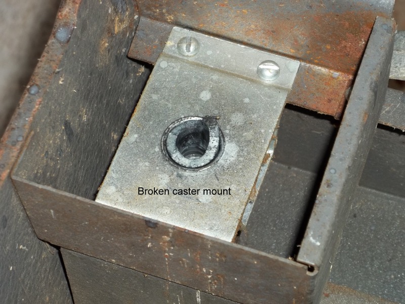

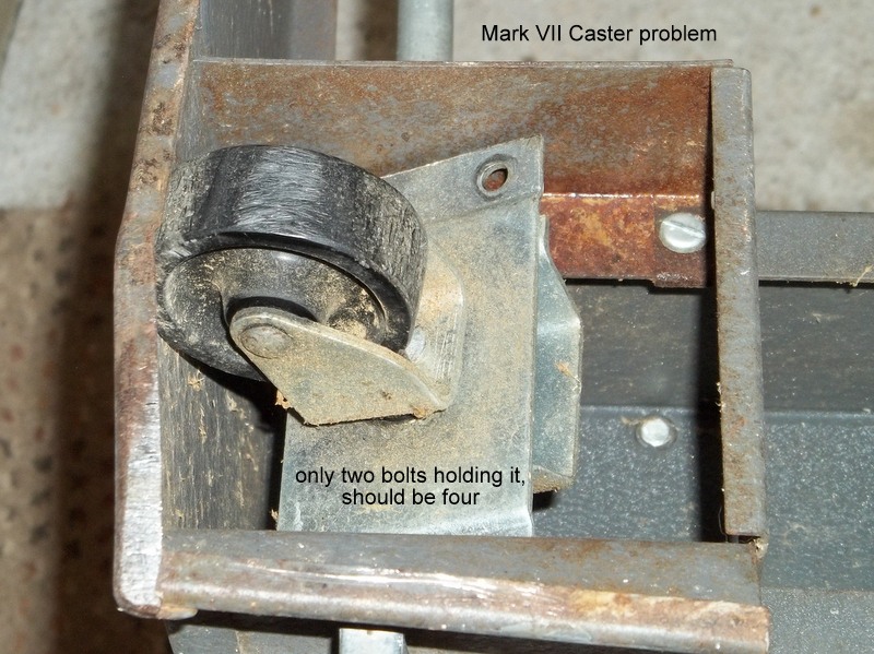

However, this other little caster problem is not so easy. Haven't looked to see if a replacement part is available. Just gonna have to live with it for now.
[ATTACH]17312[/ATTACH]

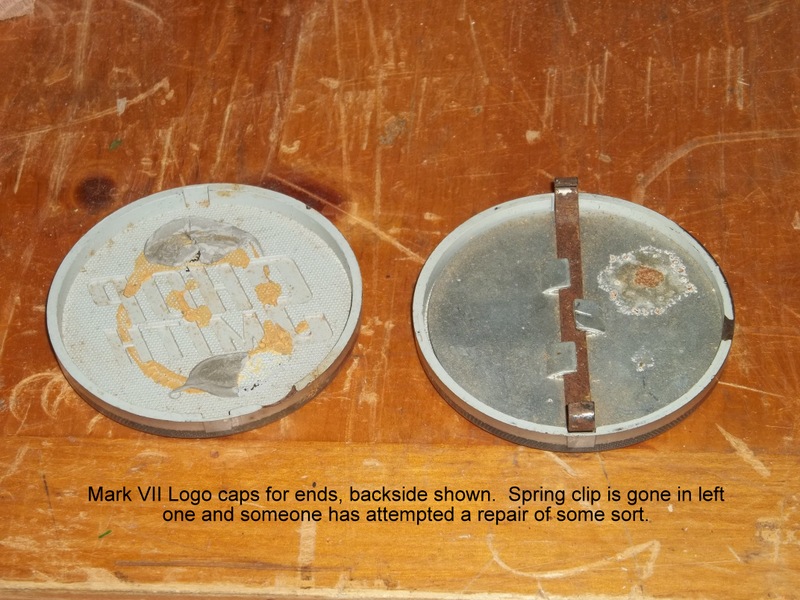

Then there are the irritating little challenges like this, purely cosmetic but would be nice to fix.
[ATTACH]17313[/ATTACH]

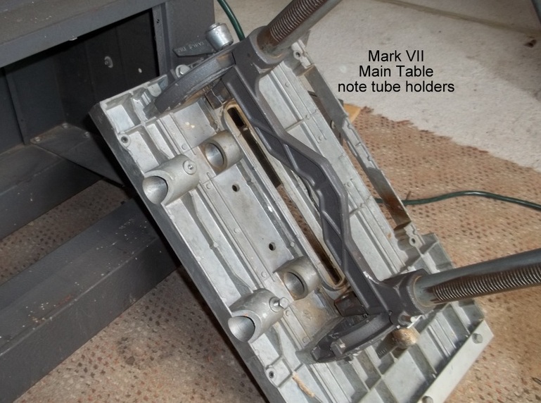

And then there's the joy of discovery. While putting things back together I noticed this feature of the main table. This is really cool and seems like a really good idea. Now I have to go back and read what to use it for.

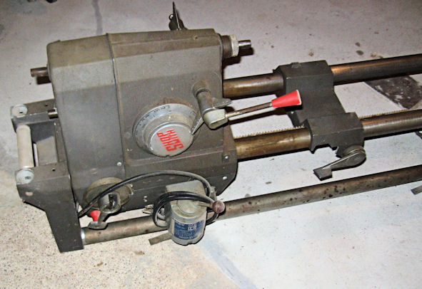

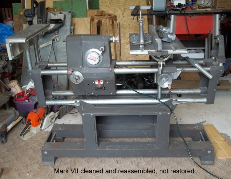

I've made a few decisions (subject to changing my mind this winter when I have more time.) This is not a restoration, just a minor revival. I've checked things out, replaced the crumbling power cord, cleaned & lubed, and put it back together. It aint pretty, but it's functional.
[ATTACH]17315[/ATTACH]
Now, what do I do with it? I really like the reverse feature and the double tilt. For now I'm thinking dedicating it primarily to lathe usage. It can do it's shaper thing on occasion since I have the fence and insert (but no hardware). Any thoughts (bearing in mind I have the 500 and 510 for other functions)?
