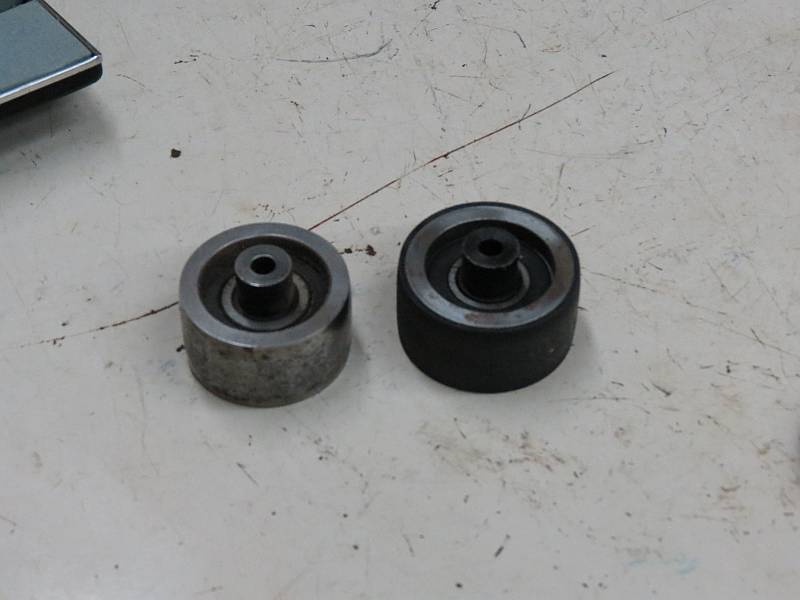

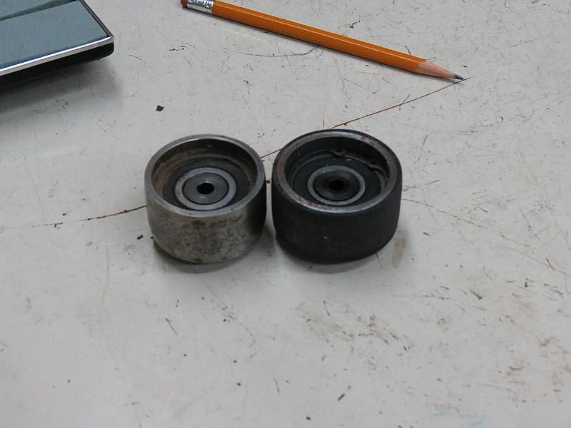

Hi,
I've got two machines with metal wheels and can get some measurements but I forgot which of the wheels were changed to plastic... If it is the idlers as was suggested by the one post then I can answer that right now.
First I have one that has no rubber banding on it and a second that does. I have had no problem with belts coming off so maybe that doesn't really matter. I can not say the bare wheels once had the banding or if they came standard that way.
The bare metal wheel measures 1.87" at the center and as close as I could get to the edge it was 1.825". The wheel with the tire measures 1.99" with a little pressure applied.

I wonder if the rubber sleeved ones are intended to be the idler that the abrasive side of the belt runs on when doing 'inside' sanding. I worry about wear on that pulley. I do not envision the plastic ones lasting very long under that scenario. I do not recall anything in my manual referring to rubber sleeves.reible wrote:Hi,

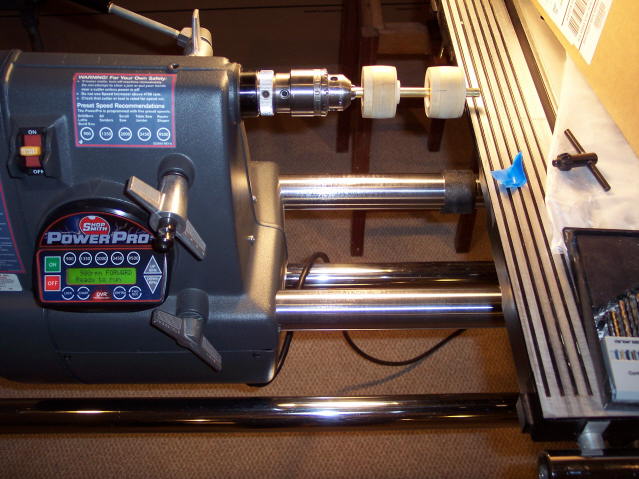

An interim update....
I thought about this and there were a few aspects to consider as different between the current-production plastic idler-wheels and the prior metal idler-wheels. Such as (1.) Mass/Rotational Inertia, (2.) Concentricity, (3.) Machined profile including crowning or lack of, (4.) Material hardness/durability, (5.) Bearing type.
I decided to save some energy and try a step to improve points (1.) thru (4.) with a minimal investment. I've increased mass/inertia/hardness by using some extremely hard persimmon wood I had on hand. It is well-machined on the lathe to a gentle crown as a starting point. For concentricity, I nailed one wheel exactly, and the 2nd wheel I should be able to improve during the glue-up between brass tubes and wheels. I'm using some brass tube which appears to be just about the same ID as the factory wheel's bushing.
Regarding point (5.), a bushing may be sufficient if I keep it lubed. Accounts of plastic wheels wearing out may be caused in large part by points (1.) thru (4.). A lazy man's speculation.....

Courtesy followup
I don't think anybody was hanging on hearing more on this thread, but here's what I found:
- The wood idlers I made were louder than the Shopsmith plastic idlers. Could have been a slight dimensional mis-match in the brass-rod 'bushings' I used. Also the mass/density of the hardwood seemed to audibly "ring" more than the plastic material.
- Having a deliberately "crowned" idler-wheel was OK for the usual strip-sanding idler (near the rear of the machine) but was a 'bust' for the alternate setup of re-threading and sanding inside a work-piece. Having a crowned idler in that configuration seemed to make the strip-sandpaper walk off the wheels.
At the end of the day, I really don't rethread and sand inside holes much (if ever), so with the factory plastic wheels I'm really satisfied after all. I lube them with some nice light grease that I use on bicycle repairs.
