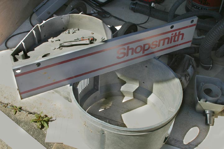

You are exactly where I was last weekend - I decided to open my DC3300 to clean it out before I start using it. Beware! ... once you get to the rotted foam you've just got to keep going (or is that just me?
). So I ended up with this: (and then I took the wheels off too!)
[ATTACH]17412[/ATTACH]
The good news is, I got it all back together again & it sucks - really well!
I scraped off the old foam seal - the foam just crumbles but the adhesive is really high quality:mad:. I tried softening it with heat with little success & eventually just scraped it away carefully with an old chisel. I used a mild solvent to get the last of the sticky off & washed that off with lots of water. Hopefully before any damage was done to the plastic! I left the one strip on the Main Housing at the joint with the top of the motor housing (see note below).

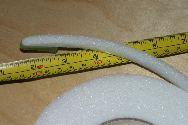

Then I applied 2 parallel strips of 1/4" square draught/draft* excluder foam where the old foam had been. It's done the job perfectly (might even have got away with a single strip) & I've now got a nice clean vacuum that works well. I used 1/4" width purely because that's what the store had!

I should mention that I used another vacuum to clean out the inside of the DC3300 & the filter hood which was thickly caked in dust; I couldn't see anything that would need maintenance apart from that. After re-assembling I started it up outdoors - a wise move considering the cloud of dust that came off the hood!:eek:
BTW, the hood can be washed - cold water hand or machine. Air dry.
The only problem I found was that, for some reason, the 2 self tapping screws that pull the motor housing down onto the main body (pt no. 515137, 21 on exploded drawing) were not present so the main body to motor housing seal is not perfect; I've temporarily sealed that with packing tape until I get the right screws. Anyone know the size?
