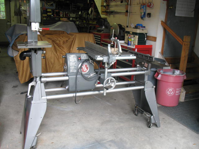

Hi I just got another Shopsmith, I could not pass it up. It started life as a gold model but the original owner upgraded to a new headstock and table in 1995 and the original gold parts need a make over. I have 2 additional Shopsmiths now [ I cant help myself ] and they are both from the mid 1980s. I noticed that the bench tubes on the goldie appear to have a finish on them. I plan on cleaning them up do I need to refinish them with some kind of coating or just treat them like the ones on my mid 80s models. Thats to say shine them up and put some wax on them. Is there any difference in the type of steel they are made of? Thanks in advance for any help

As it turned out I just cleaned and shined them up and coated them with some Boeshield T-9. I use that stuff on my cast iron table top [Unisaw] and it seems to keep it from rusting. if it becomes a problem Ill remove the bench tubes and paint them. I also stripped down all the parts and painted them gray to match the headstock.
- IMG_2015.JPG (62.55 KiB) Viewed 2671 times
