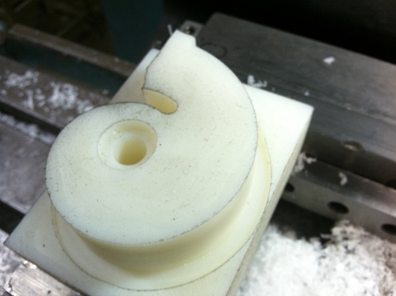

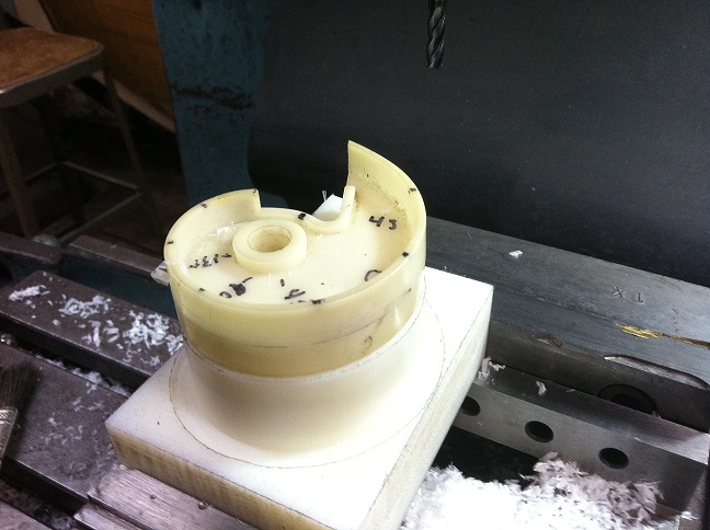

new beefier Cam Speed Control
Post by gpartin »
in the works...just an update
Shopsmith 0012.jpg (146.02 KiB) Viewed 4010 times
Shopsmith 0021.jpg (121.16 KiB) Viewed 4004 times

Post by briallpro »
gpartin wrote:in the works...just an update
Please keep me in mind when you have these made.
