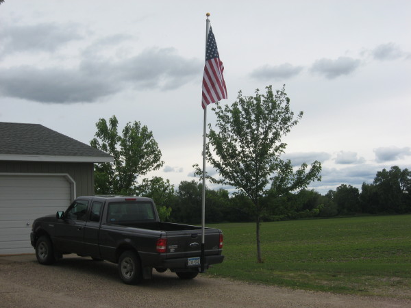

[ATTACH]17519[/ATTACH]Change of plans on the portable flag pole.
welded a 2 inch pipe to receiver hitch drawbar
and put the pole in it.
simple , done deal, will fit any vehicle with a
trailer hitch that is 2 inch.
drive truck to picnic, display flag,
end of day put flag pole back in origional
box. store in garage till next time....:D :D :D :D
oldc6
Posts: 233
Joined: Mon Feb 11, 2008 9:22 pm
Location: central minnesota
Post by oldc6 »
should have explained a little better.Menards had these pole kits on sale
a week ago for $49.95. Nice three piece aluminum three section pole with
flag. made in Wisconsin...... fits real nice into two inch pipe....
picture is for static use only do not drive down road with pole installed
into hitch.........:rolleyes: :rolleyes: :rolleyes:

Post by a1gutterman »
Nice job, oldc6!
