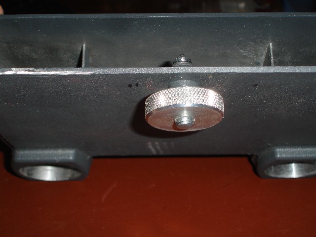

Double Tilt Lift Issue
I figured out why I had an issue with my double tilt lift upgrade "failure". The lock knob was defective. The knob was retracted in on the screw post so the post did not engage the rod on the base as well as it should have. (see photo) Although it seemed OK, when I attached the power lift and raised the rails, the pivot arm came off and torqued and snapped off the corner. The lock knob should be flush with the end of the screw post & not move.
As I mentioned in my other posting, Shopsmith promptly agreed to replace the lock knob and pivot arm. (This was before we figured out what the issue was.) Shopsmith's engineer contacted me to sort out the problem. This was an excellent experience with Shopsmith's customer service.
- Lock Knob.JPG (81.35 KiB) Viewed 3259 times
