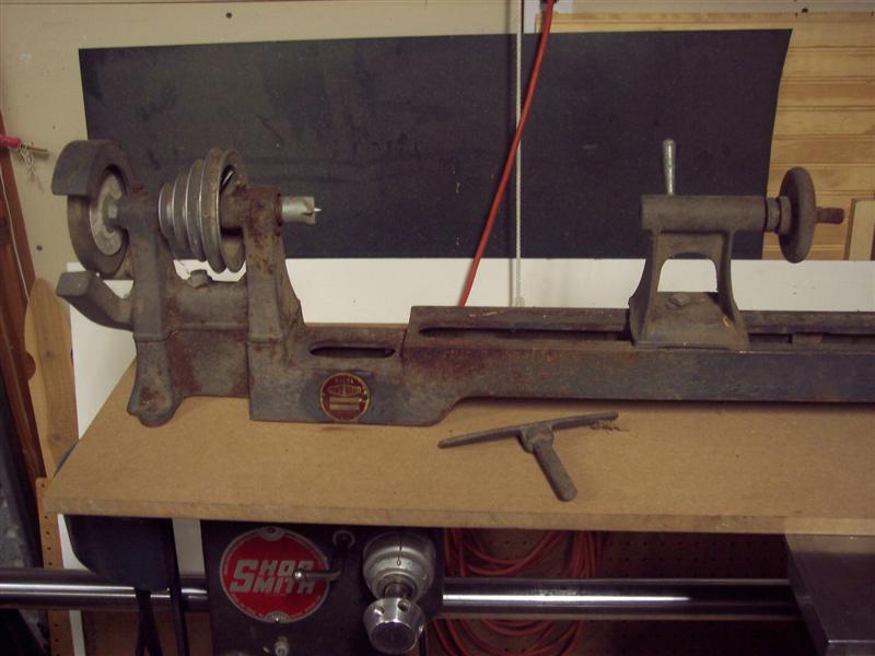

It's not a shopsmith I know but...
A friend of my son's was cleaning up his garage the other day and found this.
It's a Dunlap 534-0601 Circa 1941 or so. Which he offered to give to me and I accepted. He said it was his grandfathers
It needs a motor. I'm thinking some kind of variable speed motor would be good. I'm completely open to suggestions here. I know several of the old shopsmith 10ER users have converted to DC motors for variable speed so that is also a possibility.
Fittings
3/4 x 16 tpi spindle with MT1 socket, tailstock is also MT1. I have a 1 x 8 spindle adapter for this thread pattern so my chucks should work.
I did a little bit of research on this model and it is very similar to the old Craftsman 101 Convertible series. This too is a convertible model which can add metal turning capabilities (I just have to find the compound tool rest that will fit this.) The headstock bearings are actually bronze bushings, I need to get a dial indicator and check the runout. There is no noticeable side to side play currently and after some light machine oil in the oiler holes, the spindle turned freely. I have seen one on OWWM where the owner had the headstock milled to acept sealed bearings.
Overall this is in good shape and should become a decent restoration project and spindle lathe. If I can get the metal turning capability, so much the better. Paint is better than 90% so I won't repaint. It does need a thorough cleaning and rust removal. There is very light rust on the ways and bare metal portions. The cup center and spur drive are stuck fast so I need to wrestle those free. approximately 1 3/4 inches of travel in the tail stock.
Wish me luck!!
This is going to be fun.
Terry

I have the Dunlap model, and it is completely restored with a motor and everything. I use mine to turn pens.
I changed out the nuts that are used to hold the tailstock and banjo in place with knobs sold through Rockler, and they make tightening and loosening everything much easier.
I have a straight AC 1/4 HP motor (no variable speed) attached to it and just use the pulleys to change the speed. I find that the four speeds are good enough for what I use it for. The motor is on a hinge system so I just need to tilt the motor towards the lathe to move the belt. When the motor is in the running position, the weight of the motor keeps the belt tight on the pulleys. Makes changing the speeds easy-peasy.
I built a wood stand for it and find it works great for the small projects that this lathe was built for. Have fun with the restore, you'll enjoy using it once everything is cleaned up and running.:D
