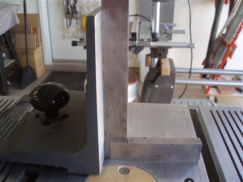

I did a quick and dirty frame out of 2x4 stock this weekend to mount casters on for a furniture/equipment moving dolly. I used my Tenon Master to cut half lap joints for the corners. At assembly time, I noticed there was more twist to the joints than I thought there should be....even using construction grade fir 2x4s. So, I grabbed the trusty Starrett combination square (yes, the square is square) and started checking.
The gap at the bottom is somewhere about a strong 1/32". Enough to make a real difference on long tenons (or lap joints in this case):

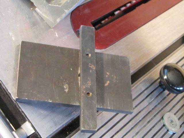

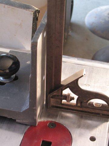

I checked to make sure the two assemblies were tight to each other. No built-up gunk on either side of the plate with the miter bar:

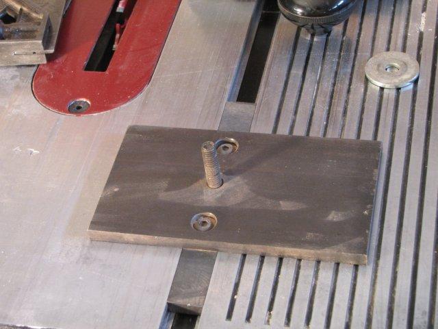

No gunk on the bottom mating surfaces:

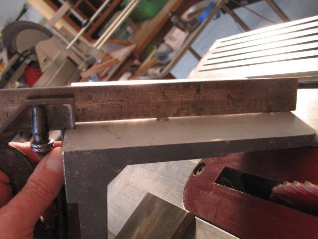

The milled contact areas on the bottom of the aluminum top part are not square to the face of the jig:

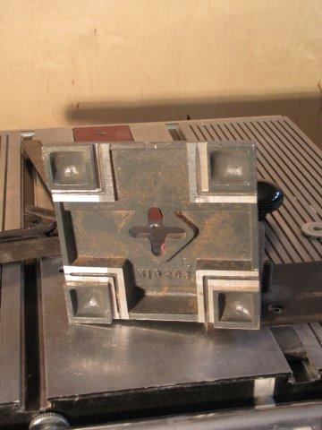

I dismantled mine to check the face with the mined surfaces on the bottom and at first thought I had the same problem as you describe. But since I use this frequently and have never had this issue with tenons (I do not typically make long tenons), I reassembled it and checked with the table top.
It is dead on. No light shows through.
[ATTACH]17673[/ATTACH]
Tenon Master 003 (Custom).JPG (64.4 KiB) Viewed 1185 times
Mine is also dead on square. Recommend a call to Shopsmith to see if they will do anything for you.
