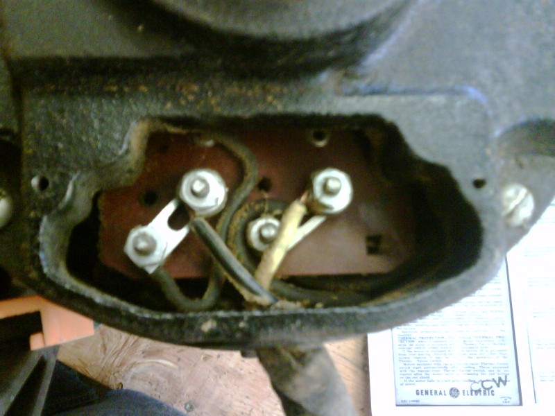

I am in the process reassembling a 10er that I bought last fall (just cleaning, repairing and replacing missing/damaged parts, not a full restore at this time). The problem I hope you can help me with is that as received there was no power switch and the motor had only about a foot of wire attached and it was solid wire(like house wiring not multi strand).
The motor it came with was made by GE Canada and is a dual voltage 110/220 model. The information off the plate is
MOD 11F800UA TP KC
FR 65 A 11.2/5.6 V 110/220
CY 60 RPM 1725 PH 1 HP 3/4
YK
Here is a picture of the terminal plate.
[ATTACH]17753[/ATTACH]
I want to run it on 110v but am concerned that it may currently be wired for 220v. Any insight would be appreciated.

Since the current input wires are connected in what appears to be a 'parallel' connection, I believe it is wired for 110v. A 220v connection would include a 'series' connection.
Notice the spacing of the terminals. The terminals currently 'jumpered' are spaced the same as the two middle terminals. A 220v connection would be the incoming wires to the outer two terminals and the center two terminals jumpered.
Not clear from the pix, is which terminal the internal wire from the right connects to. If the lower/middle terminal, it all makes sense - if it connects to the upper/outer terminal a bit of confusion exists. It is possible that the motor has always been connected for 110v and the internal wires are functional as connected. I believe the internal wires need to be connected across either of the upper or the lower wider spaced terminals for a 220v connection. Reason being, the start circuit is usually intended to be a 110v circuit. The internal wires are most likely the start circuit and direction of rotation is controlled by their polarity. So although the current connections are suitable for 110v (in whatever direction it runs) they are connected somewhat illogically.
That be my 'guess'!:)

JPG40504 wrote:Since the current input wires are connected in what appears to be a 'parallel' connection, I believe it is wired for 110v. A 220v connection would include a 'series' connection.
I tried wiring it up and it runs like a top,:) so your 'guess' be right on the money.:)
