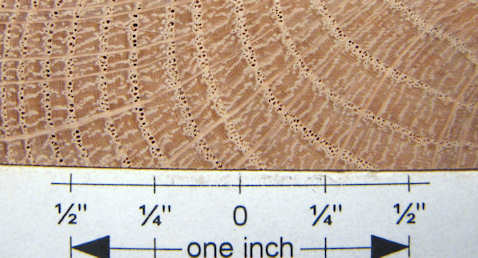

Art, the pen in front is Red Oak and the other two are Black Walnut. A friend at work gave me the wood from his farm here in Huntsville Texas.

Fred, it's tough to identify small pieces of wood, especially from a photograph. Maybe red oak in Texas looks different than what I see up here in Pennsylvania. But, the red oak I see has a rather distinctive coarse grain pattern. Here's an example of a pen made with red oak (at least the bottom half is red oak) -- http://www.etsy.com/listing/101993513/h ... mpaign=api
If you have additional samples, you can look at the end grain. There should be a series of tiny holes. Here's an example --
[ATTACH]17791[/ATTACH]
- oak, red southern 2 end grain closeup s25 q60 plh (1).jpg (29.93 KiB) Viewed 2721 times
