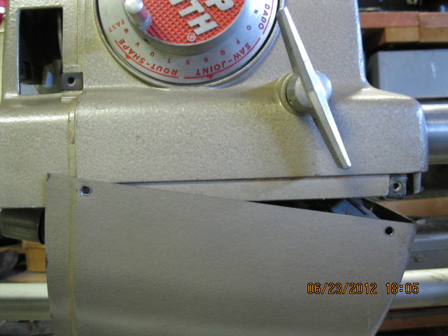

I removed the 5 screws holding the bottom pan to the headstock and one of the screw inserts fell to the bottom of the pan. Can anyone tell me how I can get to the bottom of the pan so I can get to the screw insert...and also clean the sawdust out of the pan? While I am in there would I be able to put on a new belt? I tried attaching a picture to this post to show the dilema I am in.
Thanks for any help.

helm wrote:I removed the 5 screws holding the bottom pan to the headstock and one of the screw inserts fell to the bottom of the pan. Can anyone tell me how I can get to the bottom of the pan so I can get to the screw insert...and also clean the sawdust out of the pan? While I am in there would I be able to put on a new belt? I tried attaching a picture to this post to show the dilema I am in.
First reattach the pan to the headstock temporarily. Manually rotate the quill(use the sanding disk as a handwheel) while slowly increasing the speed control to fast.
Next slip the belt off the motor pulley(pulling the floating sheave out will allow the belt to go more slack).
Disconnect the motor wires from the power switch and the motor and pan will be free to travel. The clip should slip out with any accumulated dust. Blow the rest out. Squeeze the clip so it will not fall the next time.
