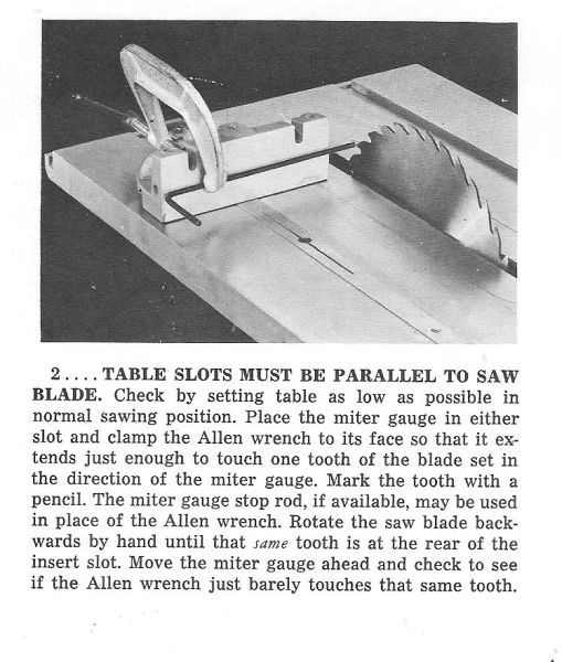

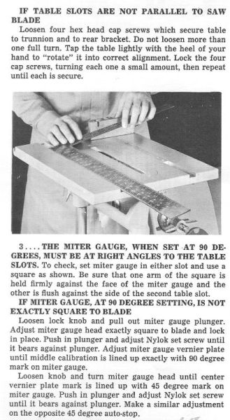

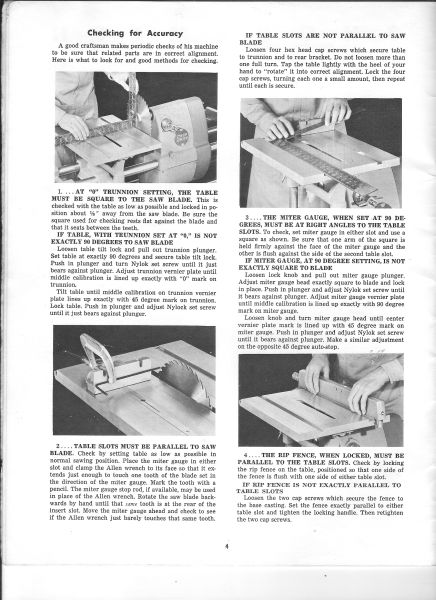

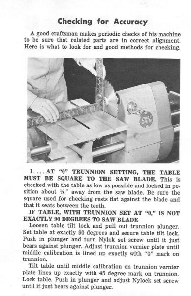

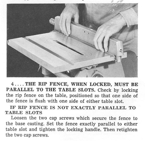

I am amazed the PTWFE online version does not include basic table alignment.
If this is too difficult to read, I can split it up into 4 different pix.
[ATTACH]17858[/ATTACH]
- basic table alignment reduced.jpg (61.66 KiB) Viewed 2187 times
Did it anyway.
[ATTACH]17859[/ATTACH]
[ATTACH]17860[/ATTACH]
[ATTACH]17861[/ATTACH]
[ATTACH]17862[/ATTACH]
Pix are of a Mark 5, but all the steps are the same regardless of model.
- basic table alignment a.jpg (53.83 KiB) Viewed 2187 times
- basic table alignment b.jpg (67.68 KiB) Viewed 2190 times
- basic table alignment c.jpg (57.58 KiB) Viewed 2189 times
- basic table alignment d.jpg (89.39 KiB) Viewed 2191 times
