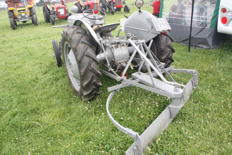

Here is another hoop example. I have a tractor blade just like this one (except this one has more paint :)). The locking point is at the front next to the tractor. I have another that locks at the pivot point kind of like a RAS. The hoop / quadrant design is far stronger and does not flex like the other. Note that on the tractor blade the hoop moves instead the arm but it works the same sat up the other way.
[ATTACH]17973[/ATTACH]
temp ferguson and blade.jpg (171.56 KiB) Viewed 548 times
