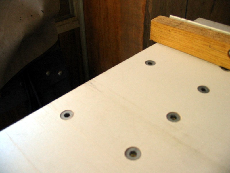

The weather's been hot for over a week: glad we air conditioned the place a couple of years ago. I miss SD, but we live in a condo there]For grins, here are a few shots of the jig and the holes. I temporarily mounted the jig with the thumb screws used to hold the fence. Here is the jig mounted on the right side of the table:
[ATTACH]18016[/ATTACH]

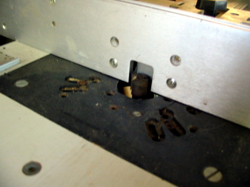

Here a 3/4" bit centered in the fence:
[ATTACH]18015[/ATTACH]

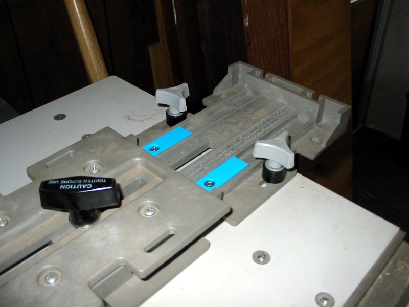

Here is the mirror image set of holes on the left side of the router table:
[ATTACH]18017[/ATTACH]
There is plenty of adjustment to allow centering the fence. I wonder if you have one of the earlier tables. I know that my documentation speaks to a number of upgrades that included the table.
