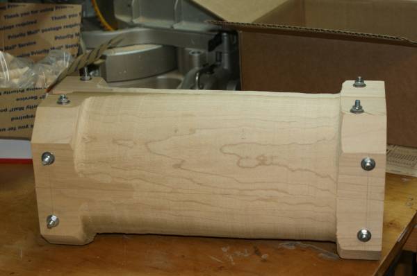

The project starts out as a billet of poplar consisting of four parts that are bolted together.
[ATTACH]18031[/ATTACH]

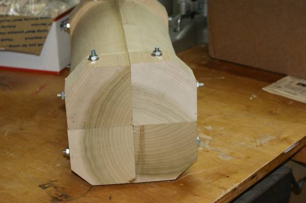

Here is the view of the end of the billet showing the bolt pattern
[ATTACH]18032[/ATTACH]

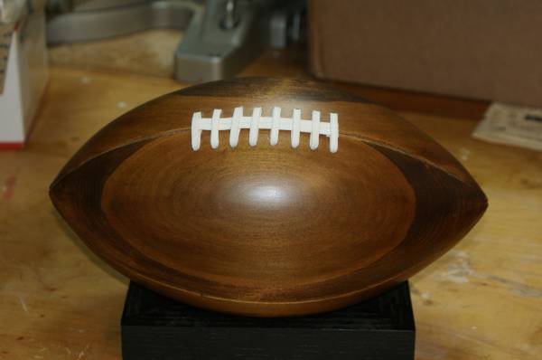

And here is the finished product. Don't try to throw one of these things, it weighs about 8 pounds!!:eek:
[ATTACH]18033[/ATTACH]

He uses the bolts cause using glue would prevent the pieces from coming apart after turning. After he turns the football he parts the waste off on the bandsaw and feehand shapes the tips of the ball on the belt sander. The main sections of the ball are double sided taped together so they can be separated and then run on the router table to highlight the seams.
Early versions that were only glued at the ends(where the bolts are) had a tendency to separate while turning

Methinks they are bolted instead of glued so after turning the edges can be chamfered to make them look more like real football seems then glued.
